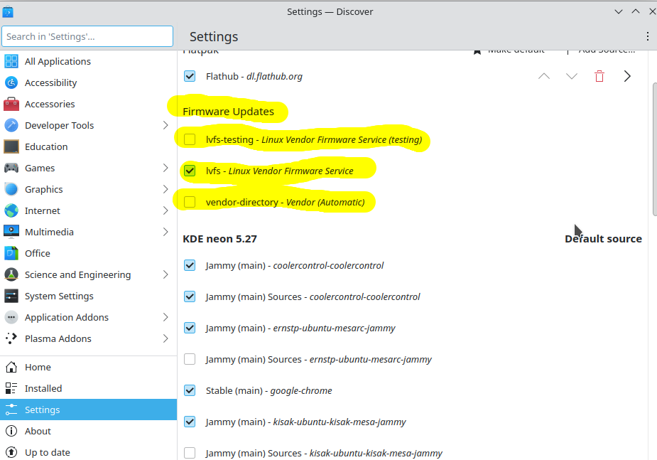

      it just means that there is a problem with the firmware repository (unrelated and separate from OS updates)
      I don't think this gets in the way of normal system updates.
      You may want to try enabling the middle option, and disabling the 'Automatic" one or disabling all of them if you want.
      I have seen it set to the bottom option for some reason, which always gives an error.
      Click image for larger version  Name:	Screenshot_20230427_113228.png Views:	0 Size:	111.7 KB ID:	670450
