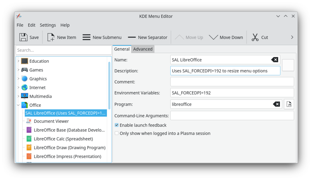

    I needed to use LibreOffice Writer for the first time since I switched to Debian Bookworm. I don't remember the UI font size being a problem ... but ... the toolbar menu option fonts are 8 point, and that may be generous. LibreOffice used to have a UI scaling setting but apparently that's been removed for some time and the dev's are adamant about not restoring the feature.
    My solution is to create another KDE Menu entry title "SAL LibreOffice" and give it the following configuration:
ID:	675061 One could putz around and add that setting to other LibreOffice menu entries but this works for me.
