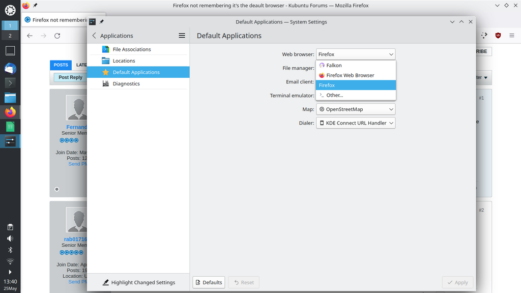

                            After snap Firefox, weird things might happen. For example, I have two Firefox entries in default apps, one pointing to a removed snap (I think) and the second one with no icon, to binary from Mozilla. See if you have another entry for FF. It's a long shot but...
                              Most oddly, I actually have two entries pointing to the same snap (apparently)
