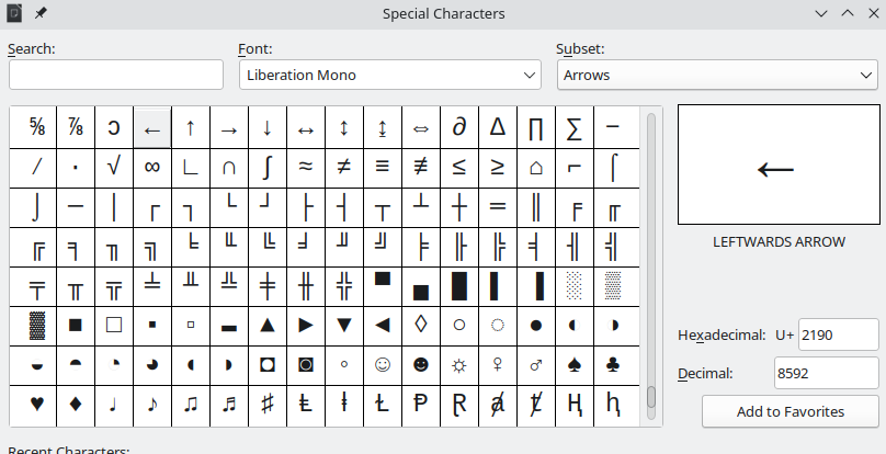

    This is a LibreOffice Writer problem. I have done a fresh install of 7.3.3.2 on my box. The program is working well (so far) except for one thing. When I try to insert special characters, none of the familiar characters appear. Whether I choose Basic Latin, Latin-1, or Nabataean (whatever that is), I get a very limited selection of characters (40), all of which the Special Characters pop-up informs me are Nabataean. Unfortunately, I am not Nabataean. I need relatively standard special characters, such as a section sign, a paragraph sign, copyright and registered trademark symbols, and stuff like that.
    I have even tried uninstalling and reinstalling LibreOffice, both from the command line and through Synaptic. (I know that's a very Microsoftean of me, and I am appropriately embarrassed.)
    The other thing I've noticed with the Special Characters box is that I cannot insert the hexadecimal values for the characters I want. If I backspace to delete the hex for a Nabataean character, I can erase the digits, but then an uneraseable "D" appears in the box.

          Everyday presents an opportunity to learn something: Nabatea was a political state of the Arab Nabataeans during classical antiquity. Being so, it has a limited special character set. Switch to a Liberation font (default for LibreOffice) from Noto Nabataean and you will find pretty much every special character.

            I have tried rab's suggestion, without success. I'm annexing two screenshots to this post. One shows the "palette" I get when I click on the special characters icon on the toolbar. The other shows a larger view of the palette. Over where it theoretically allows one to type in a hexadecimal designation, you can see the letter D. I can't get rid of that to allow me to enter a hex code. For the decimal window below that, it either shows "13" or "1," and I can't get rid of that either, so I have no way to enter an appropriate code.
            The font I am using is New Century Schoolbook, which has all of the special characters I need. Linux's own version, Century Schoolbook L, also has all the characters. unfortunately, entering either in the Font window kicks the window back to the Nabataea display.
            On the other hand, I just discovered quite by accident that if I just type C into the font selection box, a font called C059 loads, with all the characters I need (indeed, apparently all the same characters that either of the Century fonts has, and it appears indistinguishable from the Century fonts, at least to my increasingly old eyes. I can go with that, though it is a bit frustrating not to be able to solve the original problem.
                C059 is the New Century Schoolbook font, depending on where you look or what you downloaded.
