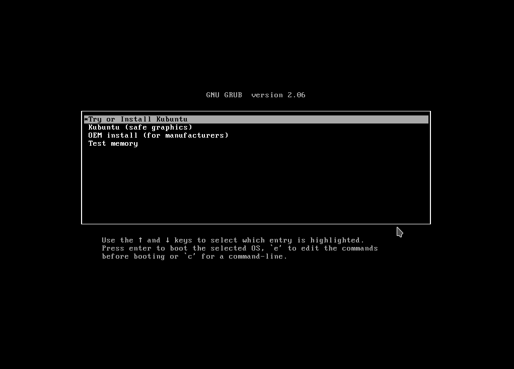

    I have the iso on a flash drive as a bootable device. It worked great on my laptop and my husbands laptop but I can not get it to install on this desktop. It is stuck in a loop. It goes to the try or install screen. I press enter. Then it flashes something I am unable to read then goes back to the try install screen again. Then again the same thing.

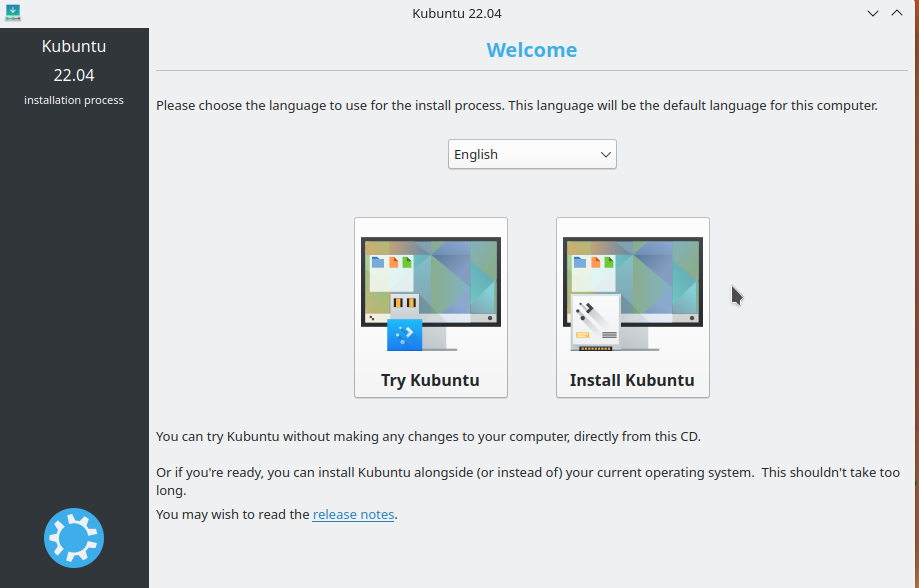

              By this, do you mean:
              Click image for larger version  Name:	Screenshot_20230316_122706.png Views:	0 Size:	4.5 KB ID:	669142
              or this:
              Click image for larger version  Name:	Screenshot_20230316_122758.png Views:	0 Size:	59.7 KB ID:	669143
              If it is getting to the second one, a possible corrupted USB stick is entirely possible, even though it did work on other machines. It might be worth trying to create a new one, even with a new stick if you have one.
              A common boot option to add for some situations is nomodeset, which can help with graphics compatibility for the install, as well as after, if necessary. Depending on the specific hardware, it might be needed if you are only getting to the first screen.But a bum USB stick is still a possibility here as well.

                claydoh--- I am going to try your suggestions when I get home Saturday. I am away from my desk. I am getting the first try or install screen. Not the second. I will post again saturday after I try these things. Thank you.

                    The install started. Here is what fixed it. Thanks to Claydoh and Schwarzer Kater for all your help.
                    I tried turning off legacy mode and that did not work. I did leave it off though. Then I used the nomodeset link that Claydoh posted and followed the part 1 instructions and it worked. The install started. I am so happy.
