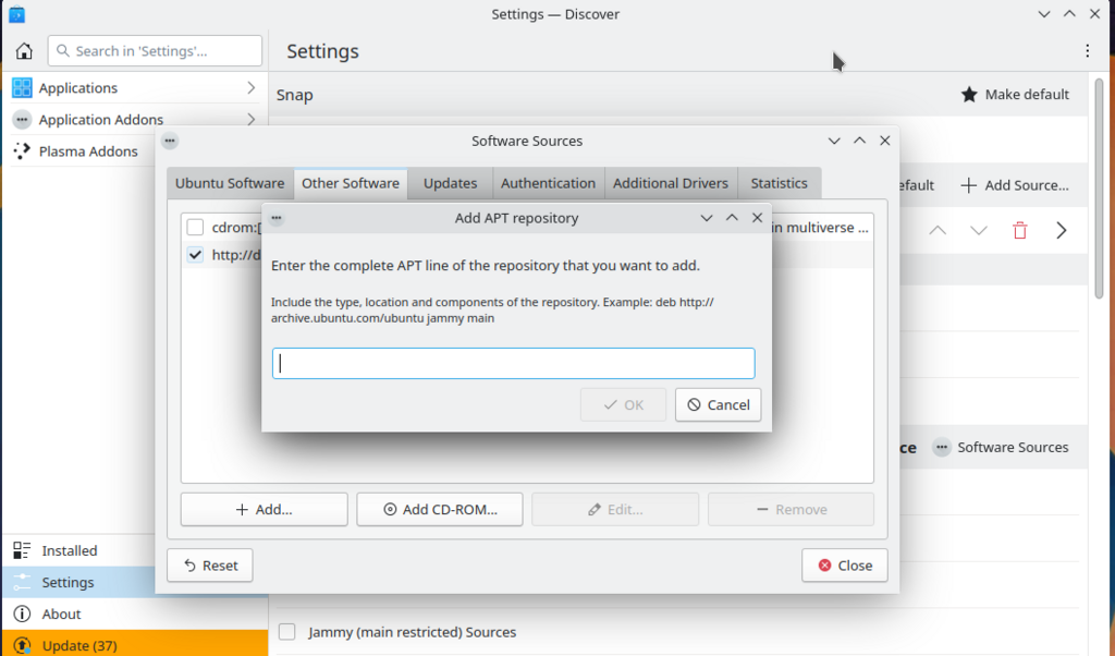

    Can I add a ppa and install new software using Discover? Or is it a PITA and apt is easier for that?
    No, not directly. You would need to use Kubuntu/Lubuntu's Software Sources utility that you can get to from Discover's settings. It is useful for general apt configuration, and you can add a PPA from there, but it is far far quicker and easier to use the cli.
    You can paste a PPA url here:
    Removing a PPA doesn't downgrade things if deleted from here, iirc. ppa-purge is still needed for that.
