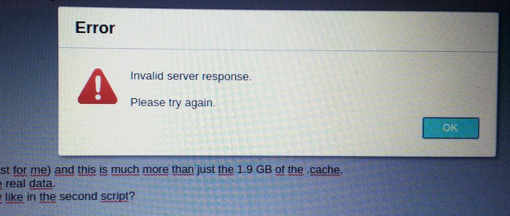

                  but I get approx. 10 times:
                  "Error
                  Invalid server response.
                  Please try again"
                  and I have to click on OK.
                  This doesn't shine to disturb the copy.

                                The problem with
                                "but I get approx. 10 times:
                                "Error
                                Please try again"
                                and I have to click on OK."
                                Occured again.
                                Would you know what is going on?​
