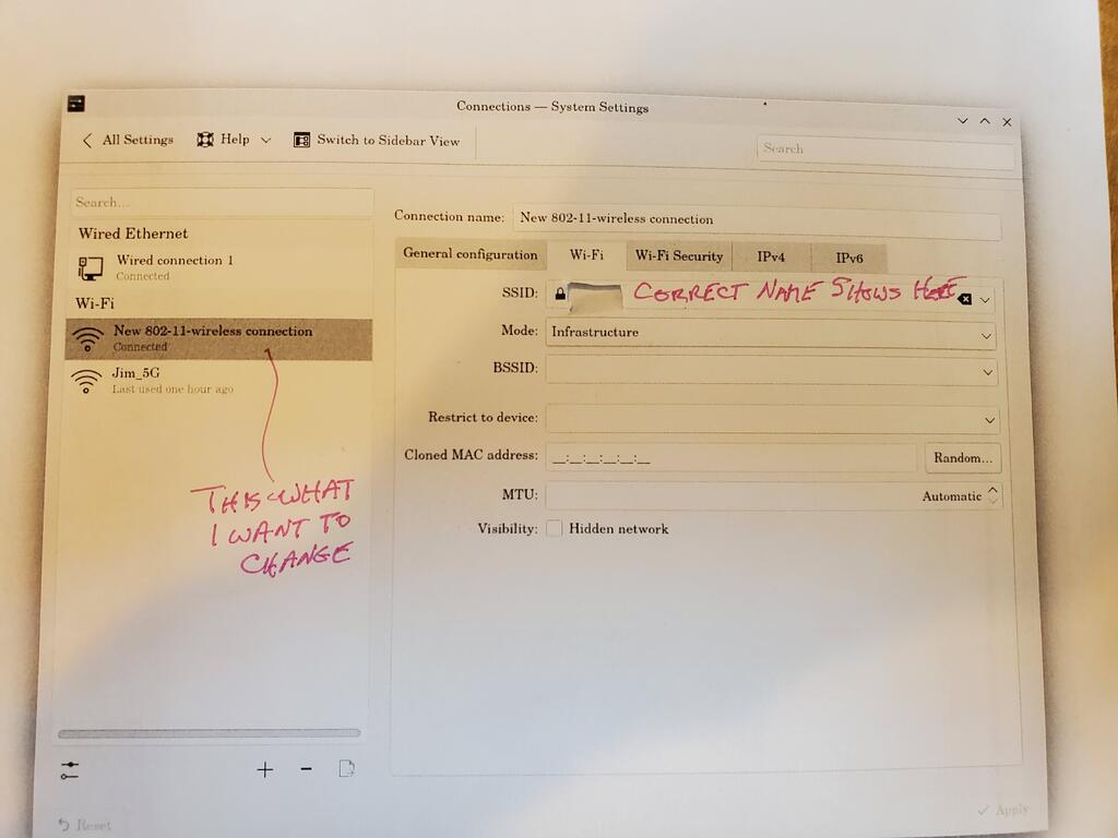

    I have a new wifi card, Aorus GC-WBAX210. If seemed to work right out of the box, recognizing all my networks. (On each band, I have a guest and a mac-protected network.) Except it would not connect to the mac-protected networks. So I deleted the old 2.4 mac network and created a new one with the same name. It works, and I can connect to it. The only problem is that it shows up as "New 802-11-wireless connection" rather than under the network name. I have given it a priority higher than my guest network.

    New 802-11-wireless connection e253ed5a-7bb5-41d9-a413-af75aaa96aea wifi wlp5s0
    Jim_5G c2f2bdc1-4a93-4ad6-8ea2-552feb006aae wifi --
    ​Jim_5G is my guest network.
    My new connection is on the 2.4G band. I probably can use the same procedure to recreate my mac 5G network, but it will have the same name. (I know because I tried it, then deleted it.)
    How do I "rename" the new connection to its actual name? When I go into Connections--System Settings, the new network's name appears properly in SSID. It is not a hidden network. But the network listing on the left shows the connection as New 802-11-wireless connection, and that is what I need to change. Right-clicking on it gives only the options of disconnecting or deleting.

    Right above the SSID on the right pane, you will see "Connection name". Edit this to whatever you want.

      Hi, claydoh. That's the problem. The SSID does show the correct name where you have your home network's name greyed out. It's the left-hand pane that shows "New 802-11-wireless connection."
        It occurs to me that I may just need to do a factory reset on the router and then recreate my networks. I had hoped to avoid that, but if the router thinks my "correct name" is still a network, that explains why the new connection comes up with a different name no matter what I type in the SSID box.
          I figured it out, and I win the dumb prize for the day . . . perhaps for the decade. I was looking at the SSID name. The connection name is changeable in the box above the tabs that says (confusing the hell out of me) Connection name:
          The problem that never was is now resolved. Apologies to claydoh for wasting his time.
