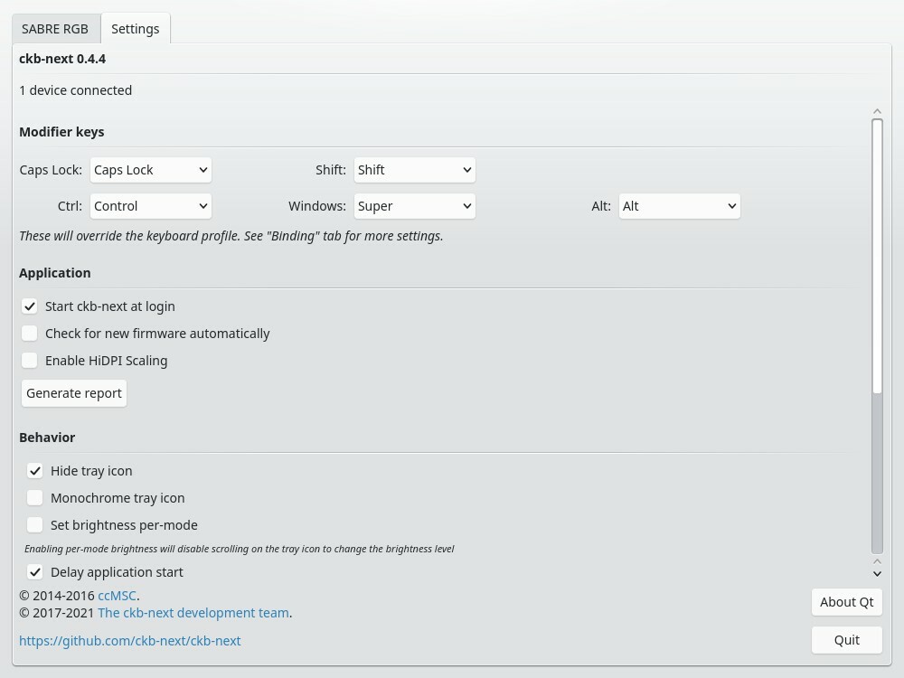

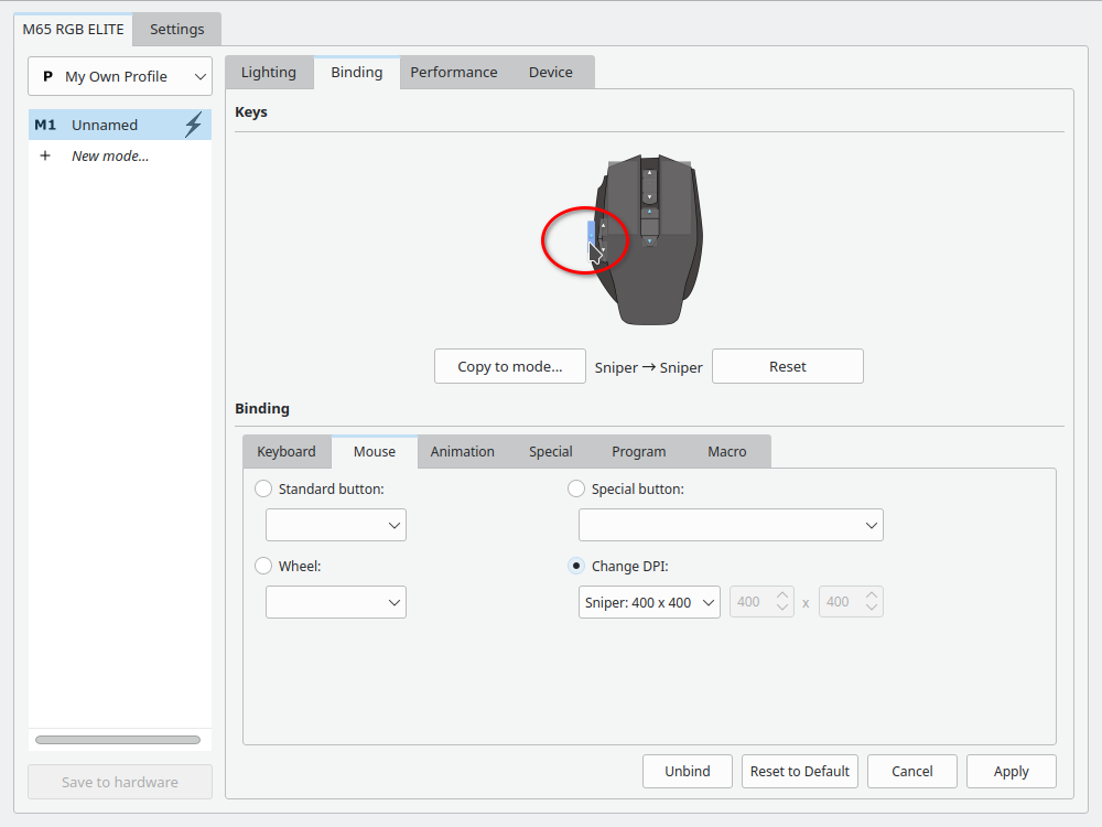

      Can you post an image of the settings in the application, with the appropriate button on the image clicked?

      Click image for larger version  Name:	Screenshot_20230411_120209-1.png Views:	0 Size:	54.1 KB ID:	669947

        I don't remember the exact model of mouse, but the screen is almost identical.
        I have accidentally clicked the 2nd middle click button, within FIREFOX, and it works today. Maybe my mouse is afraid of what Claydoh was going to do to it, or something to do with the update 2 days ago, and a full poweroff reset. (Yes I've done both of these before hand, and nothing worked) it's the middle button behind the wheel highlighted light blue in image
