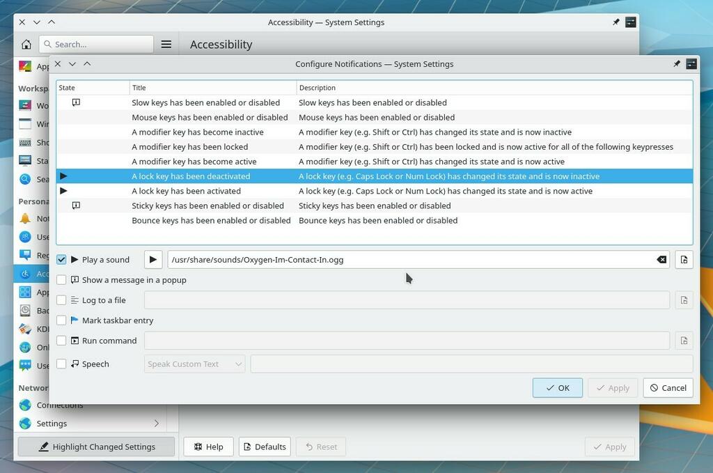

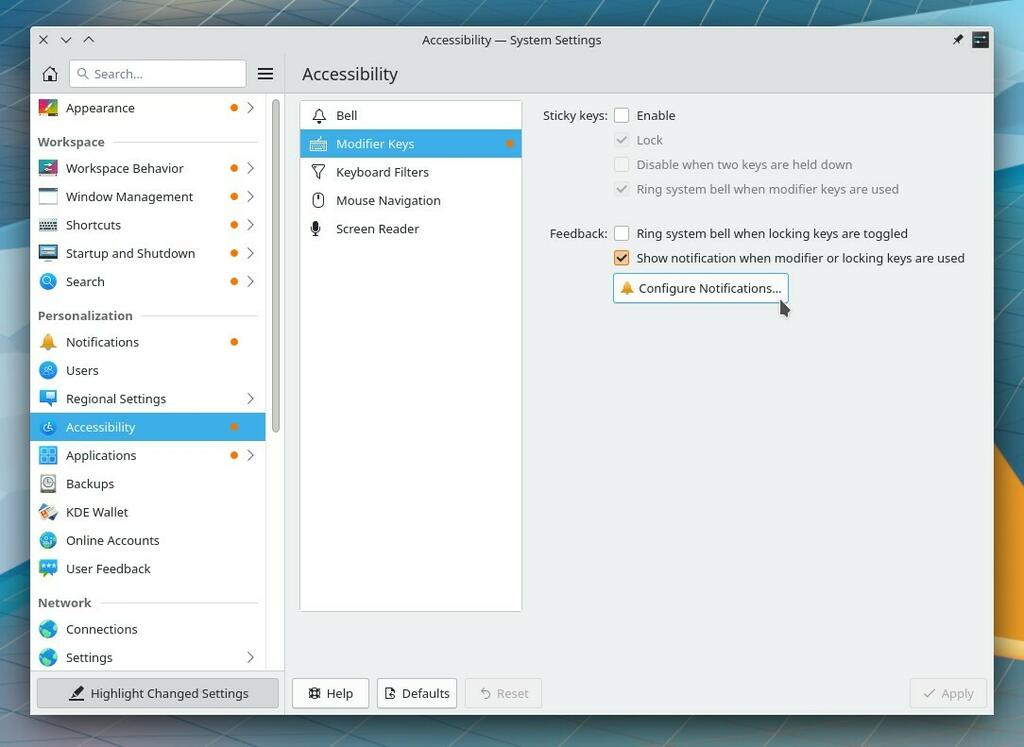

    Hm, hm… Sorry, perhaps my description was not good. I logged into my test installation of KDEneon (recently installed, up to date and no extra PPAs) , switched to English and took some screenshots:
    Click image for larger version  Name:	kfn_neon1.jpg Views:	0 Size:	63.6 KB ID:	667194 Click image for larger version  Name:	kfn_neon2.jpg Views:	0 Size:	94.4 KB ID:	667196 Click image for larger version  Name:	kfn_neon3.jpg Views:	0 Size:	95.5 KB ID:	667195

    This could be a bug or at least a bad description of the different options (but I think you can get it working, at least I could):
    System Settings -> Accessibility -> "Special Keys"(?) -> Feedback -> enable: "Show Notifications when modifier or locking keys are used" (the other settings - like "Ring system bell when locking keys are toggled" - do nothing for me…) -> Configure Notifications -> define a sound for "locking keys pressed" and one for "locking keys released" -> Voilà!
