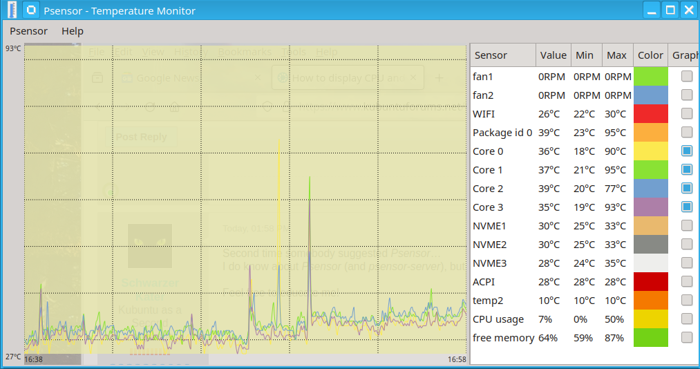

                    Here's what it looks like ...
                    To drop it down to the tray, click the top right "x". The icon will stay in the tray.

                      Thank you for the screenshot, but how does Psensor display selected temperatures in a panel then? For an example see e.g. the screenshot in post # 5.
                      Because that is what this thread originally was about…

                        It's not going to do that. It is it's own app. Of course it's Linux, so maybe you can rewrite it
                        But, seriously while it's a very good app, I don't believe it's going to satisfy your expectations.

                          Ah, OK - thanks for clearing this up. Because I have never found any option in Psensor to display something in a panel (and sometimes one can be "blind").
                          So the "new" Thermal Monitor plug-in seems to be the best option - at least for future Plasma releases - so far.
