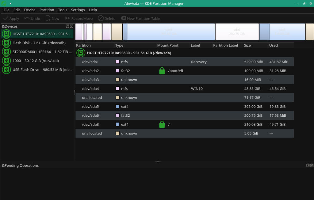

    Hi everyone. New user to Kubuntu 21.10, just getting everything set up for my switch from windoze to linux. Wasn't sure which subforum to put this in. Mods, please either move this topic to the right place, or let me know. Thanks.
    Originally I was on Win10 64x, then tried switching to elementary OS by just shrinking the C: partition and adding whatever partitions elementary needed. I then installed Kubuntu, and it just took part of my C: drive, too. What I want to do is delete every partition that's not being used by Kubuntu and recover the space to my home directory. Don't forget that means I need to delete the old elementary OS partitions I created before giving up on that one before switching to Kubuntu, as well as recovering some unallocated space.
    My main concern is getting it to boot properly after making the changes. Right now, root is on /dev/sda4, but if I delete the Windows 10 partitions, won't that make my root on /dev/sda2? By doing that, won't that confuse the OS, or at least GRUB? Is it safe to delete the extra partitions, or should I just format them and shrink them all down to like 10MB each?
    I'm currently using KDE Partition Manager 21.08.1. Following is a shot of my current setup.

    Dolphin shows me a file on root called swapfile that is 2 GB in size. I'm guessing that Kubuntu doesn't use a swap partition at all, and it's safe to delete (or format and shrink) everything except sda4 and sda8.
    Related question: is it safe to format or delete sda1 since that's likely where the boot info is stored? I really want to streamline and secure my system and keep it for the long term, but I'm new. Dangit.
          No, not a problem. By default Linux and grub use UUIDs (universally unique ids) to find partitions. To check what they are you can run (in a console)
          sudo blkid
          If you want to see the gory details, you could look in /etc/fstab, or /boot/grub.cfg (very gory). /dev/sda1, the ntfs "Recovery" partition, can be used to boot if you want to reset the computer by reinstalling Windows.

          Yes, just don't delete the "EFI System Partition". You may be tempted to shuffle them around, for example to get the space used by sda1, and that can be slightly tricky, I would suggest good backups; for example, a power outage in the middle of moving a partition might leave a mess.
          I wonder what the 200 GiB fat32 partition is for. Maybe you used that to access data easily from both Kubuntu and Windows. Fat32 is much more easily borked than modern journalling file systems, so it's not ideal if you don't need the access from Windows.

            Wow, that's great news! I don't have to worry about partition labels. So you're saying I can completely remove everything except sda2 and sda8, right? I don't even have to do anything, just delete the partitions and expand the remaining partitions' sizes, right? With the EFI partiton only taking up less than a hundred MB, that means I should be able to set sda8 to the remaining portion of the drive, right? So I can just give all the reclaimed space to /dev/sda8 and I'll have almost the entire drive for everything I want to install, yes?
            I guess in a worst case scenario, some of that data might be on parts of the drive that would keep me from reclaiming it all at once. I might have to reclaim, reboot, defrag, then resize the partition. Might take some time, but it would definitely be easier than reinstalling Kubuntu. I've been at it day and night for several days trying to get my only system running right.

              Ok, it rebooted! They're still labelled as sda2 and sda8, but now I have over 700 GB free. The thing is, for some reason I can't merge the space into the existing partitions, either one of them. I tried in KDE Partition Manager, GParted, and Disks. I notice though, that the entire linux filesystem is not even taking up 60 GB. Does that mean I can just backup the partitions, wipe the drive, then recover the partitions and gain all that space?

                Firstly, for video editing a swap partition would be recommended, I'd suggest the size of your RAM. If you run out of swap with that, a couple of years ago I would have said time to get more RAM, but with chip shortages and high prices... I wonder how well video editing works with a lot of swap on an NVMe.
                Secondly, I don't think you can move the partition the OS is running from. A way around that is to boot from a live USB. You likely have a Kubuntu install USB, and that will do. Boot from it and choose something like "try Kubuntu", then the partition manager should be able to move/resize things.
