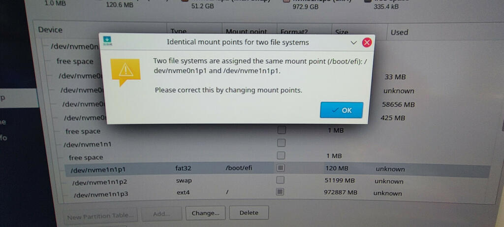

    So don't assign mount points to both EFI partitions?
    Only assign the one that is on the Kubuntu drive. Don't even look at or touch the Windows one.
    Can't tell you which one is which without more info, nvme0n and nvme1n are both of your SSDs
      nvme0n is where windows 11is installed,nvme1 is for linux
        kubuntu boot efi install on windows vol.
          can you take a picture of your partition setup?
          I wonder if we are missing important information, and this is making it harder to figure out.

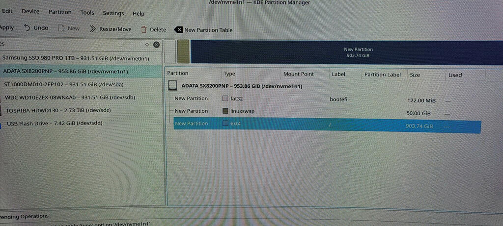

              dont like me

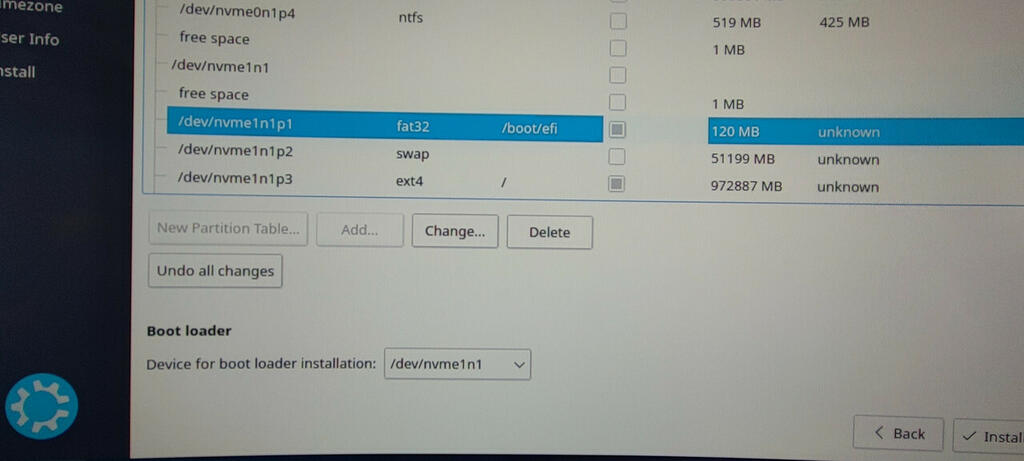

                #22
                We are not seeing nvme0n1p1. Look at that, and remove the mount point. Mark it as 'do not use'
                Originally posted by Programinjo View Post
                dont like me
                Naw, it just does exactly what you tell it to do
                  #23
                  dont like me!
                  but workaround make
                  unpluged ssd with windows
                  install kubuntu on ssd2
                  pc turn off
                  plug in windows ssd
                  boot in to kubuntu
                  sudo update-grub
                  and magic is there
                  windows have boot efi on own ssd(1)
                  kubuntu have boot efi on own ssd(2)
                  grub working
                    #24
                    but workaround make
                    This was just the the hard way to remove the unwanted mount point for nvme0n1p1
