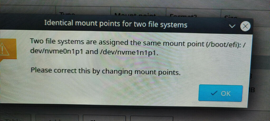

                          i do manual partitioning,but kubuntu install efi boot on windows i will try first install kubuntu then windows

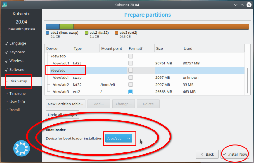

                            If you are doing manual install, if you have set up all partitions correctly, then you just need to select the correct drive as seen here (and noted in my first link):
                            Click image for larger version  Name:	Screenshot_20220412_162404.png Views:	0 Size:	128.0 KB ID:	662190
                            If you are doing this, and it is not working then there is some sort of bug.
                            This is how I do all my Kubuntu installs (always with a separate uefi), for many years now.
