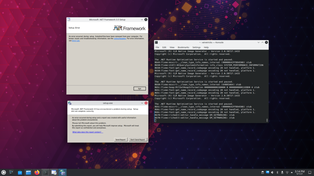

    So, I've tried installing .Net 3.5 two different ways and neither worked.
    When trying to install .Net 3.5 by clicking on it I get the following error message:
    You must use "Turn Windows features on or off" in the Control Panel to install or configure Microsoft .NET Framework 3.5
    and that's as far as you can go - click the ok button and the installation quits.:

    The second way was going by the winehq directions, under the HowTo/Notes section, which resulted in the following error message: https://appdb.winehq.org/objectManag...sion&iId=10166
Name:	winehq dotNet3.5 install error scren print.png

            Ok, again thanks for all the help. Here is where I am at, and what I've done, etc...
            "Just out of curiosity, but what version of windows do you have the WINE prefix set to?"
            The wine was using the Windows XP version, but after the following it was set to Windows 7. Not sure what that has to do with .Net 3.5 but for now I'm simply not going to mess with .Net 3.5 until I get a better handle on the wine/linux stuff. I opted to install the 'classic' version of ExpressPCB which installs and works just fine. With that...

            I tried winetrick and play on linux for .Net 3.5 and couldn't get those to work either, which is why I'm putting off messing with it until I gain more experience and knowledge with linux.
