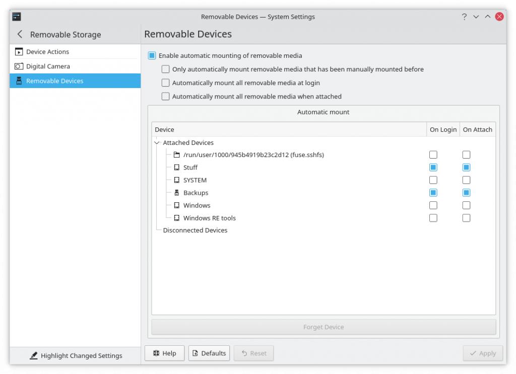

    How were you mounting the external media?
    Dolphin automatically does a mount using the "udisks" subsystem (or something like that) and not all software knows to do that. An approach that works well with your use case is to put meaningful labels on the media and use the "removable storage" screen in system settings to set up an automatic mount.

      However, as jlittle (aka the night crew ) mentions, I have no issue accessing my non-system and external drives with the cherrytree flatpak, and I do have automatic mounting enabled with some custom options to reduce my Dolphin's sidebar from becoming too full

          I still have Leafpad installed. I went to:
          System Settings ==> Removable Storage ==> Removable Devices ==> Enable Automatic Mounting of Removable Media
          It made my OS always auto-mount external media. That didn't help. In Dolphin, I clicked on all my thumb drives to make sure they were mounted. That didn't help.
