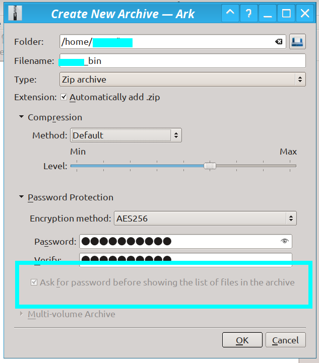

    I don't know what I'm doing wrong, but Ark is not working as expected. I want to password-protect some files; that part works fine--but the option to require the password before viewing the archive is grayed out:
    I've tried changing every option to see if it became available, but no. WTF?
    It works using rar and 7-zip (7z format), if those are installed. I will guess the feature is not supported in zip files, or not by the system's zip executable.
      Yes, those are all installed, @claydoh. I've never used 7-zip, so I thought I'd stick with familiar types. I wanted to save these as tar.gz files, but that offered no password protection at all. When I saw that zip does, I thought it was a mistake/problem that the choice was grayed out for prompting for password when viewing the archive.

          As mentioned, zip format only encrypts the files, not the zip "container", so file metadata is still readable. You can work around that by "double-zipping" (that is create a zip first [doesn't need to be encrypted, and can be another archive format like tar.gz], and then rezip it as encrypted, password protected zip).
          Using 7z is nearly always a better and easier option, though, and quite good for a quick and easy solution. For heavier encryption needs, I'd go with gpg (mainly for it's versatility, and asymmetric public/private key encryption, although you can also use symmetric passphrase encryption with it).
          gpg does require a bit of studying and configuration to use it effectively to it's full potential, even though there are graphical front-ends to it available [kgpg, kleopatra].

              There are are quite many implementations of zip out there (and all standardization efforts are fairly recent, and have been met with varying degrees of success...one more reason to use other formats). It's possible some recent implementations do have metadata encryption, but I don't think that is part of the "standard" format.
