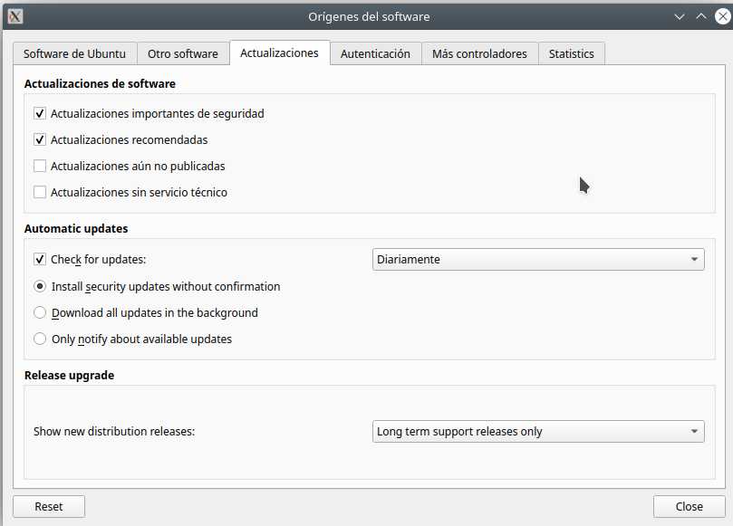

          This is my extra repos (well, all my repos)
          Edit: I don't made any more change, only, sure about any of kernel 5.8 installed, now, I can install that you indicate in your first reply...

            What about here:
            Did you read the post I linked to?
            the package
            linux-image-5.8.0-43-generic is not in the stock repos, but is in the testing 'pre-release-updates', and as you can read from that post, it can make things messy.

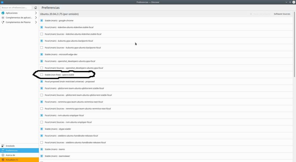

              Hi Claydoh,
              Sorry, I did not see the link to the wiki, I did see the link you put to the forum, but the link to the wiki, I missed it, now that you mentioned it, I have reviewed the whole thread and I have seen that there was no link viewed.
              But after seeing your screenshot, mine has surprised me very, very much, something that I had not looked at because, I automatically deduced it was not necessary, since I never, but I NEVER touch that aspect or that configuration in the updates, I leave it as it comes in the fresh install, with security updates.
              And this is the surprise that I have taken:
              How is this possible?
              What program that I have installed has been able to make this modification?
              The programs that I install, in my repos, can be seen, none "strange" or "dangerous".
              Now I understand why, at one point, after installing hwe-20.04, linux-image-5.8.0-43 was installed, without being stock
              Really, I am speechless, not knowing what to say ...
              And above, the "Pre-released updates" I can not uncheck it, the most is to leave it in bold as seen in the image, but I can not leave it completely unchecked.
              I must say that the other day, synaptic asked me if I wanted to continue receiving Opera updates (which surprised me) and that for this I added a repo (I understand that Opera had already added it) is the "only" thing that has been strange .. .
              But I do not know since when I have that configuration, because as I mentioned, since I installed kubuntu 20.04 (like all versions) I leave only marked what comes by security default ...
              I'm not knowing what to say ...
                I made all the steps that indicate your link (thanks for this link, its very good and important): https://wiki.ubuntu.com/Kernel/LTSEnablementStack
                I'm work with kernel 5.4, but in preferences of updates, I can't disabled or uncheck 100% "Pre Released Updates"...I search info but I can't uncheck...
                Then, when type sudo apt install --install-recommends linux-generic-hwe-20.04 go to install kernel linux-image-5.8.0-43.
                Any suggestion or idea about this?
                Thanks.

                    The other day I accessed Synaptic, I don't remember what I was doing and then I got a warning / question if I wanted to keep Opera updated (I don't remember if it asked me to add the ppa). It was strange to me because it had never happened to me and Synaptic had never asked me anything like that (in synaptic, I install, uninstall, review ... but I add the ppa's through konsole).
                    Thanks and regards!
                      Well...I can solved the problem or view what are the cause for can't uncheck the box of Pre-Released Updates...
                      Yesterday, I was open Discover and view file by file all ppa's, and view that, Opera appears like non free.
                      I uncheck the opera ppa and then, I can uncheck "Pre-released updates".
                      And this is the result:
                      Finally, I can view what are the "problem"...
                      Regards!
