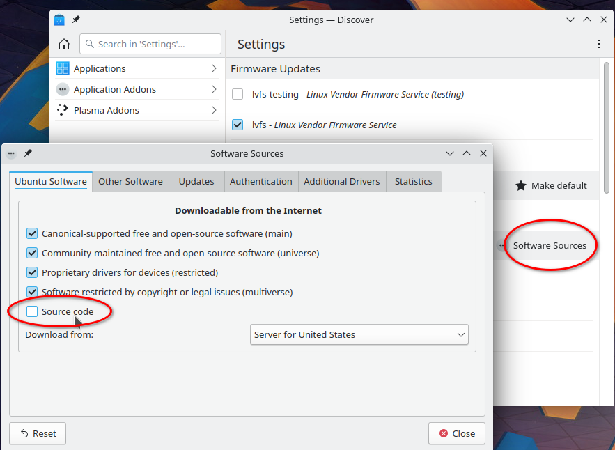

        But there is an easier way, since avrdude is available in the Ubuntu repos already, you can easily install most of the build dependencies with a couple of steps;
        First, in Discover >> Settings >> Software Sources, check the "sources" box as shown.
        Update and install (most of) the build dependencies like so:
        sudo apt update && sudo apt build-dep avrdude
        There is a good chance you will still need to track down and install other -dev packages.
