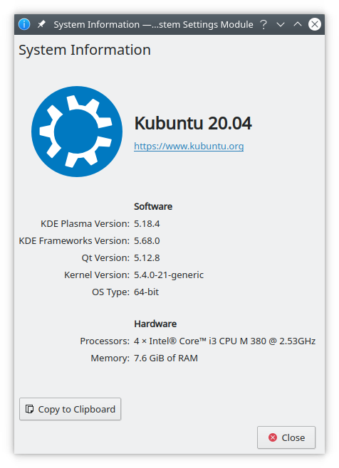

            121 updates this morning. Qt 5.12.8 here.
              [ATTACH=CONFIG]8739[/ATTACH]
              Identical to mine except the hardware section.
