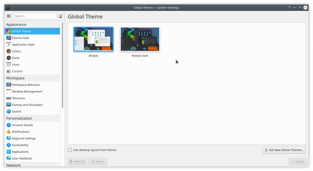

    Going directly into Global Themes, I have Breeze, Breeze Dark and Kubuntu. But clicking on Get New Global Themes produces an immediate notification "Unknown Open Collaboration Service API Error (0)" followed by long minutes of fruitless animation "wheel spinning."

      There is an issue with the kde store, where all these themes etc come from. "The Get New Struff" tool can't connect to the store API. This seems to have happened yesterday.
      At one point, the website was down as well -- store.kde.org. That is up now, so one could at least browse themes and the like. Downloads seem broken still.
      So, it is a temporary issue with a website, not an issue with Plasma or Kubuntu. This is effecting everyone

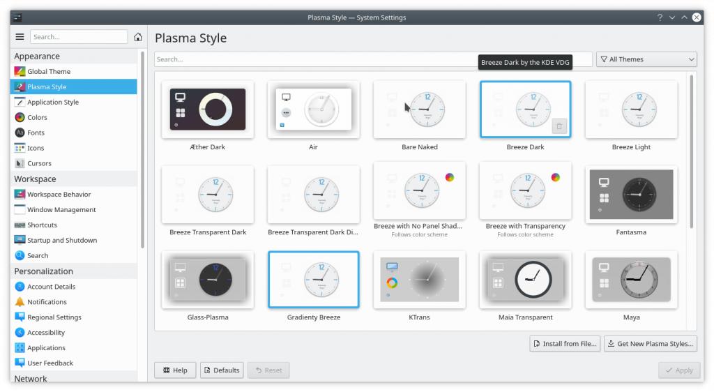

      The names of the different themeing bits has changed
      With the relatively recent Global Themes taking off, you now have old 'desktop theme' name changed to 'plasma style'
      A theme is a collection of Plasma styles, color schemes, icons, etc. Before it was Themes and ... Themes, which is a bit confusing

            So, just to be sure I haven't misunderstood the meaning here: are you saying that any component of Plasma Style can be added in (or over) a Global Theme (which I would have thought would be quite "locked")? Or are the Plasma Style components there for anyone who sets out to "build your own theme"?
              Yes, things are not locked at all
              Think of a global theme like a program in your package manager. One program may have multiple dependencies that are also installed. A Global Theme is actually just a list of components to install. You will see all the individual parts in the different Appearance sections in System Settings.
              Yes, or just want to change one aspect.
              I generally don't use global themes, other than the stock Breeze one. I like the colors, icons, window decorations, etc.
              What I do NOT like is how the Breeze panel and widgets look. So I find some transparent or translucent plasma style that has a bit of blur and use that.
