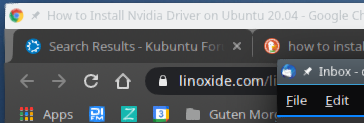

        Nope. Without Font Aliasing the Desktop is plain ugly. With Aliasing (but FXAA off) I get this blurry in nvidia-driver-455. This is the start. It then gets quickly messy.
        Going back to nouveau.
        Well, a pity. Thx though.
        Addendum: compare this to nouveau driver here:
