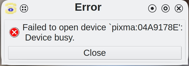

            I have reinstalled Kubuntu 20.04. But my problem with my multifunction Printer Canon Pixma MG 5750 is still not solved.
            1) There are no printer driver for the Pixma series at all. But I found the right printer driver debian package and could install it manually. Now my printer is working.
            2) The scanner is not working.It recognizes the scanner but always tell my the the device is busy. Please have a look at the attached screenshot.
            How can I make the scanner working again?

                      I tried the list of troubleshooting advices. My scanner is recognized. I installed the repository with the newest sane driver. But I always get the same message that the device is busy. What else can I do?
