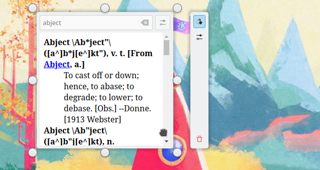

Once I began using the Dictionary widget on an 'Activities' page, its dimensions cannot be changed (made smaller), although most of the returned word definitions take up less than half of the widget window area. Why is this? Thanks...
OOTB you can resize it, but one can't make it smaller. To get the resize handles one long-presses the widget.
However, you can hack the plasmoid. The file /usr/share/plasma/plasmoids/org.kde.plasma_applet_dict/contents/ui/main.qml has two numbers, 400 and 40, and if you make them smaller, the widget starts smaller.
Long-pressing on the Dictionary widget does nothing for me. It appears that the window size is fixed by the developer, so tweaking the qml file may be the only way to resize it.
You don't get the resize handles at all? I see them here, though the width can't be shrunk down very far.
In Plasma 5.18 and 5.24 the widget has a definitely large minimum width than can't be shrunk without modifying the qml code. The height can be adjusted just fine.
On Plasma 5.25 and up, instead of a long skinny sliver, it defaults to a smaller square that is much better sized, but still has a defined minimum set.

Nope. To be clear, if it makes a difference, I tried the widget on 22.10, Plasma 5.25.5
Where, if it matters; I tried multiple spots; did you long-press on?
Maybe it’s because I added the widget to the Panel, not the Desktop? I’ll add it to the Desktop and try again.
Yes. Widget on the Desktop is resizable (long-press).
