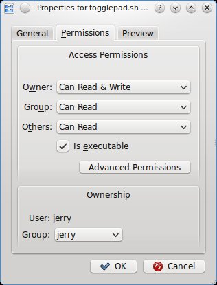

              I've attached my script (as a txt file, you'll have to change it to an sh file) and an image of my permissions settings.

                  My file permission i attached.
                  Everything tooks ok to me but I could easily have overlooked something.
