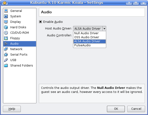

    In the VirtualBox settings for the guest VM select the Audio category. Is the Enable Audio box check-marked?
    You can also try choosing a different Host Audio Driver for the guest. Just select one from the drop down list as shown in the image attached to this post.
    If you have problems with PulseAudio in other applications (e.g. Flash applets) then that will have to be worked on separately.

      yes, I have checked the box and selected all of the options: null, oss, ALSA, and PulseAudio. all to no avail..
      Once booted, it states that "no audio device is installed"

        • For the Host Audio Driver, please select Alsa
        • Run the guest VM and see if you get sound
        • Shut down the guest VM
        • Reply here with the results of the command shown below
        Open a Konsole Window (K Menu -> System -> Terminal Program) and use the grep command shown below, but replace MyVM with the actual name of your guest VM.
        grep -i audio ~/.VirtualBox/Machines/"MyVM"/Logs/VBox.log
