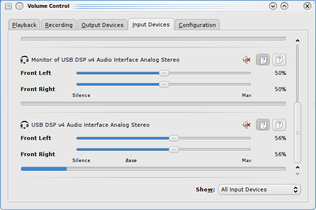

              Re: PulseAudio question in Karmic
              Thank you very much for continuing to answer my questions. It gives me hope that this pesky problems will be resolved eventually.
              Here is what happened.
              I unplugged both the Plantronic headset and webcam and then logged back in. I then reconnected the Plantronics headset.
              I opened pavucontrol and clicked on Input Devices -> All input devices.
              The result is seen in snapshot2.png . As you can see the volume meter moves when I talk into the Plantronics headset mic.

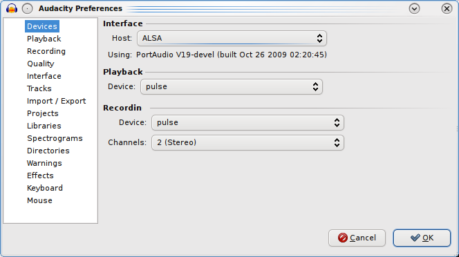

              I then opened Audacity with the following settings:
              Devices -> Interface -> Host: ALSA
              Devices -> Playback -> pulse
              Devices -> Recording -> pulse
              Devices -> Recording -> Channels: 2 (stereo) as shown in snapshot1.png

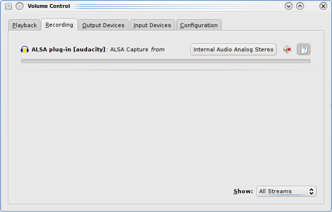

              When I attempted to record sound in Audacity, the volume meter in Audacity showed that no sound was being recorded.
              I left Audacity open and continued to talk into the Plantronics mic and then clicked on the Recording tab in pavucontrol. The Plantronics headset did not show here. The result is shown in snapshot5.png
              There seemed to be no way to choose the Plantronics mic for recording here.
              I then clicked on the Configuration tab hoping to be able to choose the Plantronics mic as the default recording mic. This did not seem to be possible here. The result is snapshot4.png.

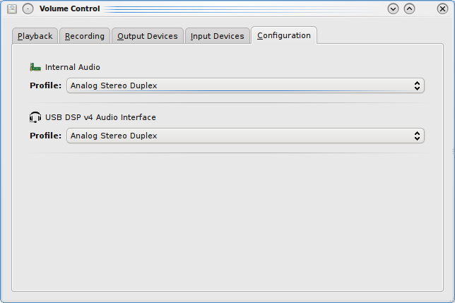

                  Now for the INPUT issues. .Under the Input tab, your deivce should be listed. Set the Show tab to "All Except Monitors" .It should not be muted, and should have some volume. It should move when you speak into the mic. If the device isn't listed, go back to the Configuration tab and make sure "Analog Mono Input" is listed for the device.
                  Go to the Recording tab. At this point, there should be nothing. Now start Audacity. Under Edit > Preferences, I have Host:ALSA Playbackulse Recordingulse Channels:1(mono). Hit the arrow box next to the mic icon just below the LR volume bars, and choose "Start Monitoring".
                  In the Recording tab, an entry should appear for ALSA plug-in (audacity). In the selection box next to that, you will have to choose your device. Then, you should have sound.
                  Then, unplug your device, and start all over, as PA forgets everything you set up.
