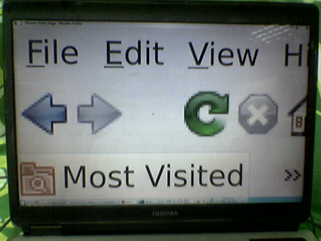

    Problem can be solved by opening system-settings through xterm session and in appearance>fonts changing "Force fonts DPI" to 96.

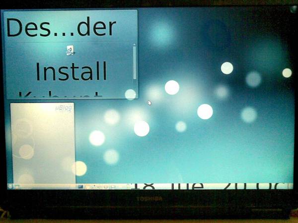

    HUGE fonts make me unable to do anything in Kubuntu 9.10 on my Toshiba laptop.
    Screenshots are attached. (screenshot 1 - desktop with live CD; screenshot 2 - what I see after clicking the K menu icon).
    It happens with live CD, and also with a hard disk on which I previously installed Kubuntu using another Toshiba laptop (Satellite A135-S4527) and connected it to my laptop. It ran perfectly on that A135 laptop, and then I had to switch to that A100 laptop, so I switched hard-disks and now I have this problem.
    I'm using a Toshiba Satellite A100-786.

      Thank you lmilano.
      With the live CD it is exactly the same problem.

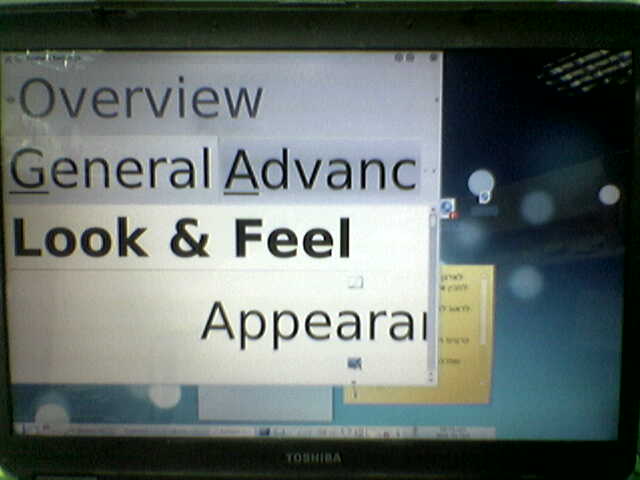

          I meant that I logged into a GNOME session. But that was a good idea. I used GDM to log into the KDE desktop, and part of the problem was solved - at least the taskbar, Kmenu, and desktop fonts were OK. But the application fonts are still huge, and there are some other problems - panel is narrow, and some other things don't look right.

            Quite a freak show, what if you run in a terminal. from gnome. systemsettings ?
            Can you check the font sizes ? Though, quite frankly, it looks as if the whole application was magnified. But I would play a bit with systemsettings and see if you spot anything fishy there.

              What happens if you go into KMenu > System Settings > Appearance, and change the "General" font to something smaller, like DejaVu sans 8?

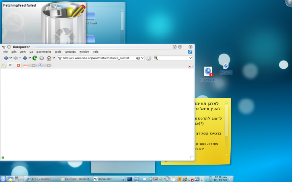

                    Then, I ran systemsettings through GNOME (and then also through xterm session), and went to Appearance > Fonts and changed the "Force fonts DPI" from disabled to 96dpi. Then I ran a KDE session and the huge fonts problem was solved! BUT, the panel in the bottom is still too narrow, I don't understand why. Screenshot attached. Any ideas?
                    Also, I'm not sure how to submit this bug - I guess I should submit it to launchpad, right? But I'm not sure in which package this problem is... any instructions on how to post it?

                      You are done my friend, just force the DPI. As for the panel, click on this weird icon on the extreme right to access the panel options, go to the advanced options, and select the option to maximize the panel, that's it.
