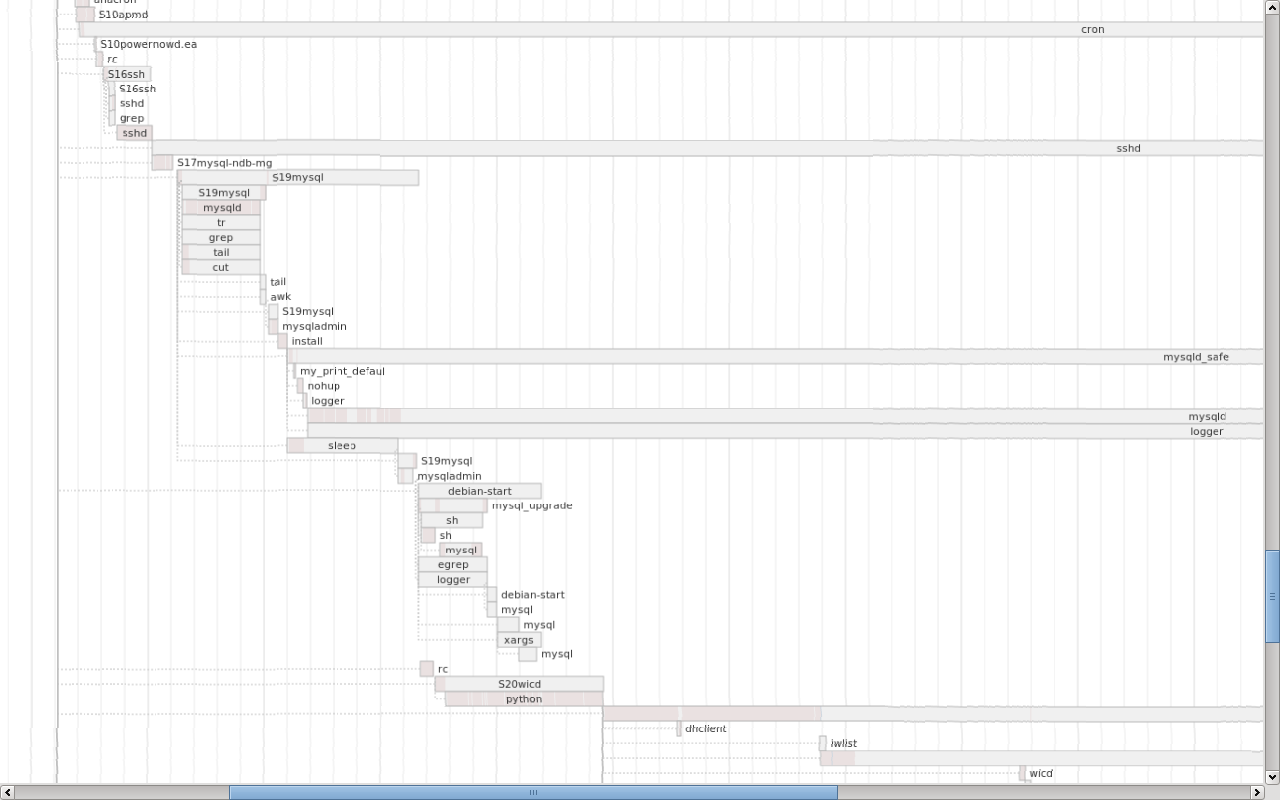

            Re: mysqld [fail] on startup?
            From the logs you posted looks like a hiccup trying to upgrade the system tables from 5.0 to 5.1. You did get the package right, mysql-server-5.1 is correct. Watch the log on the next reboot/startup. Post the relevant log messages again if the start-up errors persist.
            linux && bash = "the future"
              Thanks! - it started up this time just like last time (same log messages, no errors shown, seems OK.) This time the mysql startup lines were displayed on startup (i think that's an unrelated issue... i'm having X startup issues detailed at http://kubuntuforums.net/forums/inde...opic=3108243.0 and i believe that's the cause of "sometimes see it sometimes don't" phenomenon...)
              So i guess i'll just proceed as if everything is good to go unless someone advises otherwise. :-)
              Is there some aspect of the system i can poke to make sure that mysqld is running smoothly?
              -c
                Re: [solved?] mysqld [fail] on startup?
                Not to resurrect this issue, but i'm wondering if this is normal for anyone else when mysqld starts up (especially the last 6 or so lines)... I've included a snapshot of the bootchart section where mysql is apparently starting... looks like it takes 15 seconds, which seems way long.
                From syslog (via ksystemlog and filter "mysql"):
                2009-11-22 12:53:30 machinename kernel [ 3.467985] type=1505 audit(1258894399.980:7): operation="profile_load" pid=418 name=/usr/sbin/mysqld
                2009-11-22 12:53:30 machinename kernel [ 3.484575] type=1505 audit(1258894400.000:8): operation="profile_load" pid=419 name=/usr/sbin/mysqld-akonadi
                2009-11-22 12:53:35 machinename kernel [ 19.400349] type=1505 audit(1258923215.916:15): operation="profile_replace" pid=958 name=/usr/sbin/mysqld
                2009-11-22 12:53:35 machinename kernel [ 19.401915] type=1505 audit(1258923215.916:16): operation="profile_replace" pid=959 name=/usr/sbin/mysqld-akonadi
                2009-11-22 12:53:42 machinename kernel [ 26.400894] type=1503 audit(1258923222.916:18): operation="open" pid=1281 parent=1280 profile="/usr/sbin/mysqld" requested_mask="r::" denied_mask="r::" fsuid=0 ouid=0 name="/sys/devices/system/cpu/"
                2009-11-22 12:53:44 machinename kernel [ 27.849184] type=1503 audit(1258923224.364:19): operation="open" pid=1304 parent=1303 profile="/usr/sbin/mysqld" requested_mask="r::" denied_mask="r::" fsuid=0 ouid=0 name="/sys/devices/system/cpu/"
                2009-11-22 12:53:44 machinename mysqld_safe Starting mysqld daemon with databases from /var/lib/mysql
                2009-11-22 12:53:45 machinename kernel [ 28.487286] type=1503 audit(1258923225.000:20): operation="open" pid=1419 parent=1311 profile="/usr/sbin/mysqld" requested_mask="r::" denied_mask="r::" fsuid=0 ouid=0 name="/sys/devices/system/cpu/"
                2009-11-22 12:53:45 machinename mysqld 091122 12:53:45 [Note] Plugin 'FEDERATED' is disabled.
                2009-11-22 12:53:45 machinename kernel [ 29.258944] type=1503 audit(1258923225.772:21): operation="open" pid=1434 parent=1433 profile="/usr/sbin/mysqld" requested_mask="r::" denied_mask="r::" fsuid=0 ouid=0 name="/sys/devices/system/cpu/"
                2009-11-22 12:53:46 machinename mysqld 091122 12:53:46 InnoDB: Started; log sequence number 0 43655
                2009-11-22 12:53:47 machinename mysqld 091122 12:53:47 [Note] Event Scheduler: Loaded 0 events
                2009-11-22 12:53:47 machinename mysqld 091122 12:53:47 [Note] /usr/sbin/mysqld: ready for connections.
                2009-11-22 12:53:47 machinename mysqld Version: '5.1.37-1ubuntu5' socket: '/var/run/mysqld/mysqld.sock' port: 3306 (Ubuntu)
                2009-11-22 12:53:47 machinename kernel [ 30.725949] type=1503 audit(1258923227.240:22): operation="open" pid=1472 parent=1471 profile="/usr/sbin/mysqld" requested_mask="r::" denied_mask="r::" fsuid=0 ouid=0 name="/sys/devices/system/cpu/"
                2009-11-22 12:53:47 machinename kernel [ 30.774736] type=1503 audit(1258923227.288:23): operation="open" pid=1483 parent=1482 profile="/usr/sbin/mysqld" requested_mask="r::" denied_mask="r::" fsuid=0 ouid=0 name="/sys/devices/system/cpu/"
                2009-11-22 12:53:47 machinename /etc/mysql/debian-start[1495] Upgrading MySQL tables if necessary.
                2009-11-22 12:53:47 machinename /etc/mysql/debian-start[1500] Looking for 'mysql' as: /usr/bin/mysql
                2009-11-22 12:53:47 machinename /etc/mysql/debian-start[1500] Looking for 'mysqlcheck' as: /usr/bin/mysqlcheck
                2009-11-22 12:53:47 machinename /etc/mysql/debian-start[1500] This installation of MySQL is already upgraded to 5.1.37, use --force if you still need to run mysql_upgrade
                2009-11-22 12:53:47 machinename /etc/mysql/debian-start[1539] Checking for insecure root accounts.
                2009-11-22 12:53:48 machinename /etc/mysql/debian-start[1543] Triggering myisam-recover for all MyISAM tables
                Any thoughts? Is this normal? Thanks!
                -c
