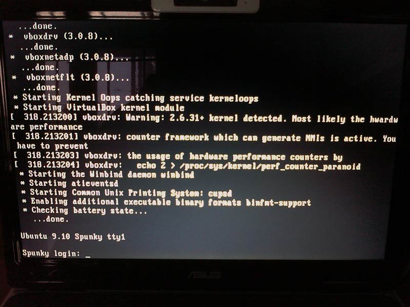

    I just installed the Karmic rc on my laptop this past weekend and it was more or less running ok. The only thing I did this morning was to launch the ATI Catalyst Control Panel and setup my second attached monitor. On restart, the boot sequence stops at a login prompt with some suspect messages displayed (photo attached). I can no longer get into KDE at all. I have tried logging in and then using the ctrl, alt, f7 shortcut. This does nothing. I disconnected the external monitor and this also makes no difference.
    I need help getting back into the desktop and figuring out what went wrong. Any help appreciated.

    The first photo is the first message I was getting on boot.

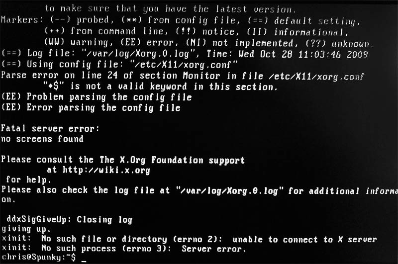

    The second photo is after I have tried the following commands:
    sudo kdm
    does nothing
    sudo /etc/init.d/kdmstart
    does nothing
    sudo dpkg-reconfigure -phigh xserver-xorg
    seems to do something but no message returned. I restart after this and still get the same error (second photo).

        PS:the second piture you posted shows that yes xorg.config is borked
        if you cant get it with the recovery moad log in at the screen in your first pitchur and do this.
        then reboot

          This appears to be a corrupt xorg.conf file. I have deleted this outside of the system (was able to boot the system as a virtual machine within virtualbox inside windows) and was able to get back into KDE. However, now kwin crashes continuously and closes.
