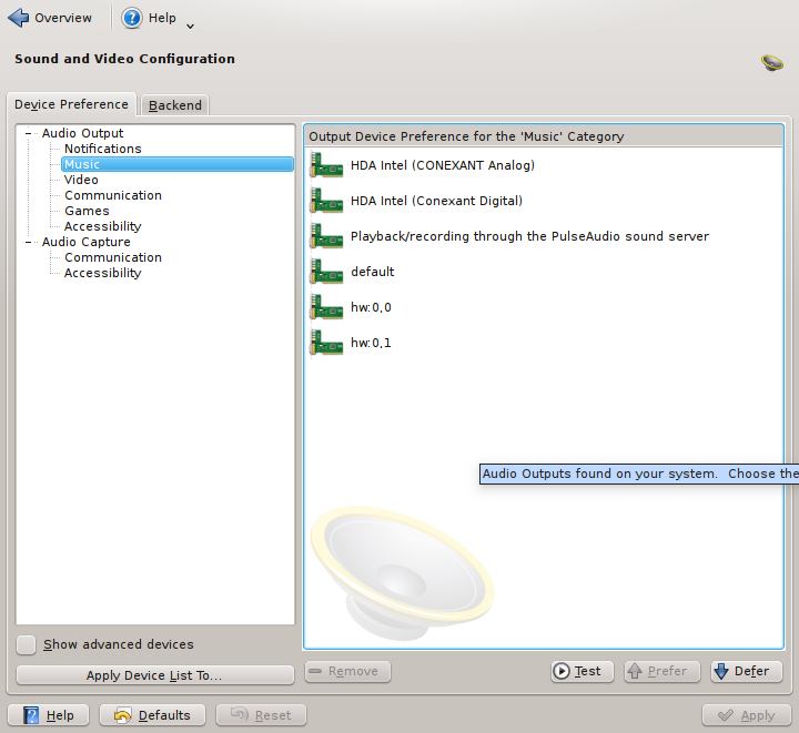

      Install, via console:
      sudo apt-get install phonon-backend-gstreamer
      Then;
      K > Applications > System Settings > Multimedia > Backend and set GStreamer as the preferred driver. Then test your sound again.
      Also, what is the device preference order in:
        Re: No Stereo Sound Playback - only Mono
        Thanks! Seems to be fine now. I'll test it out over the next few days and see if anything is still out of whack.
