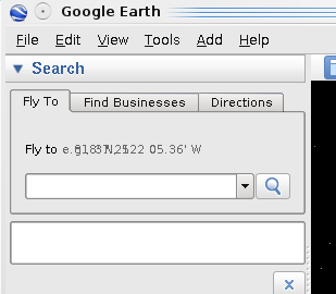

                        There are some other odd things. Tale a look at the coordinates in the attached pic.

                          I keep thinking there is some screwup with fonts. Maybe there is some hint here?
                          https://wiki.ubuntu.com/Fonts
                          I would definitely run dpkg --reconfigure on fontconfig. I actually ran a massive reconfigure the other day _-a option) and it rebuilt a lot of font related stuff. If you plan on doing that, check the man page. I think it's best to use the -phigh option and the -u too (so you don't get a million questions)
