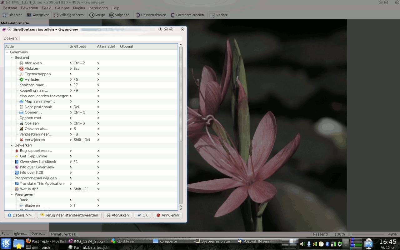

    Originally posted by Teunis
    Not a bug, 'ambiguous' means there is more than one action assigned to the ESC key and the system doesn't know which one you want to use.
    So do as the message suggest and go through the Settings Menu to hunt down the other instance of ESC, it might not be important for you (Display. Back) and then you could remove/reassign it.

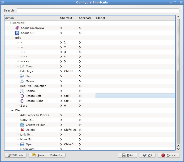

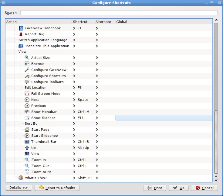

      I can't find the Back command?
      Here is my shortcut configuration dialog.
