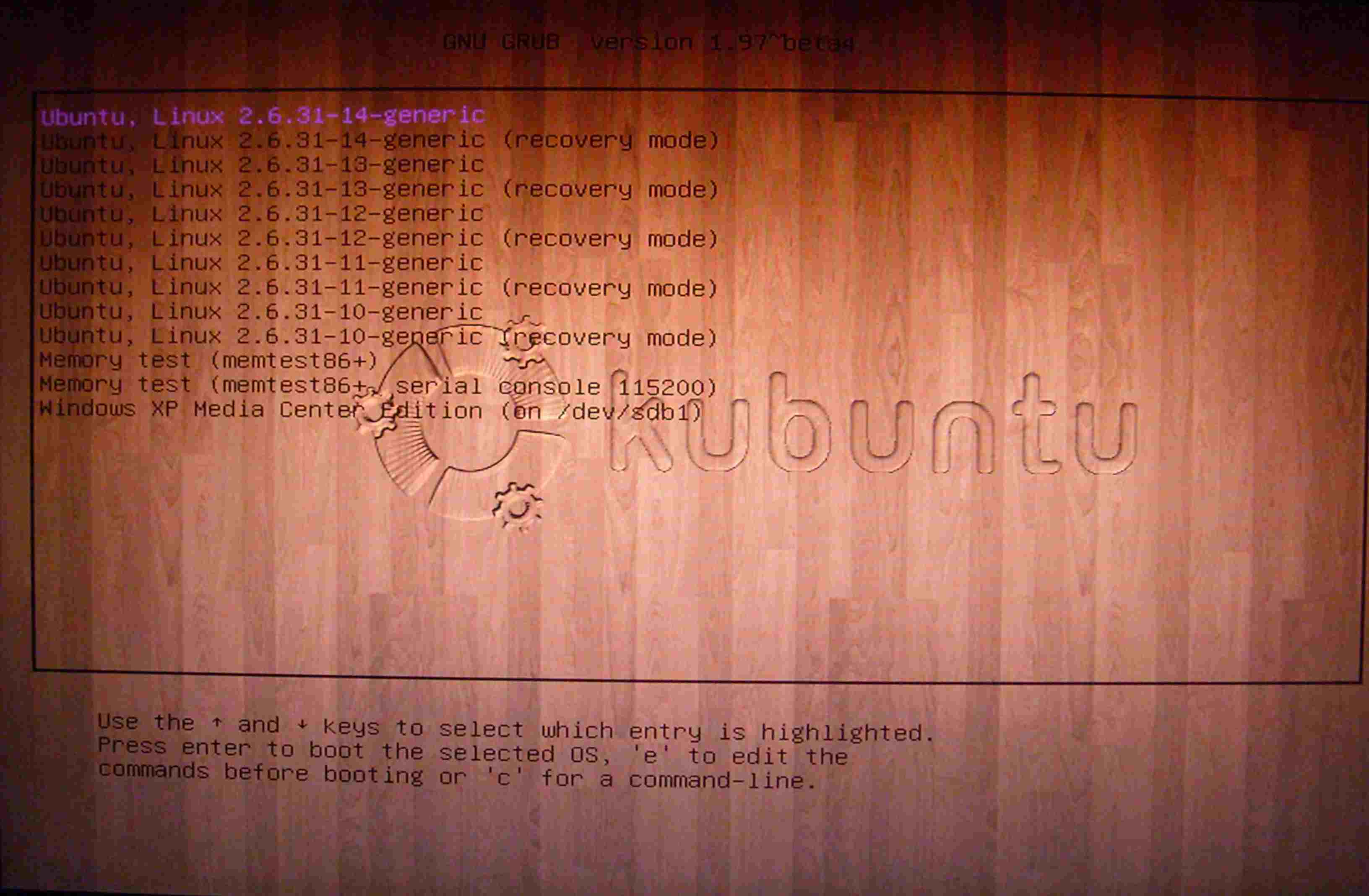

                        Re: grub2 splash images
                        TaDa!
                          MoonRise, cool. Nice graphic to summarize the end result, too.
                          Nice work, which I'm sure others who stumbleuponit here will benefit from!
                                Originally posted by MoonRise
                                TaDa!
                                White (or something light) text would probably be easier to read on the somewhat dark splash image.
