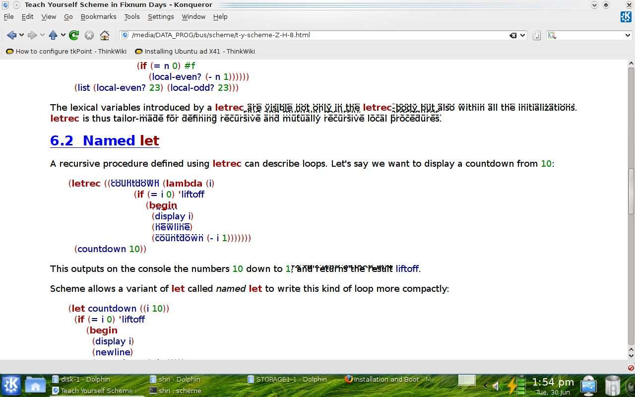

    i just finished upgrading to 9.04 and all hasn't been smooth ever since. There are some xserver problem i am facing regularly.
    When i try to play big video file (.mkv), it just logs me out and i go back to the login screen.

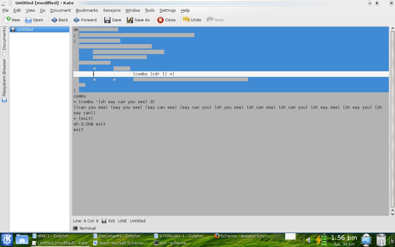

    While scrolling up and down on say kate or konqueror, the text get garbled. Only when i reload it, does the correct page reappear, but only to get garbled upon scrolling again.
