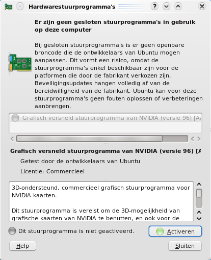

    I have tried all but still no activation and no 3d compiz fun

      I can't get the driver to activate either. I can click on the activate button until I turn blue, either nothing happens or it remains in "downloading and installing" indefinitely.
      I really do not care to go thru the procedure given in the last note. It looks too long and dangerous for me. It seems to me this should work by clicking on activate. After all, Jaunty has been around for a while now.
      In the meantime, my screen is a mess, with shaking, squiggly lines all over the place. I suspect this is related to my panoramic (16:10 ratio) screen.
      What to do? Thanks in advance.

        It doesn't reliably activate on my system either. I don't why it works on some, and not on others.
        By the way, you should only click once, then go away for 5 minutes. It downloads and installs in the background and gives you no visual feedback until it is done. You might give it one more try that way, after a reboot of the system.
        What is your Nvidia chip?

          The chip is an Nvidia GE Force 5200, dating from 2004. I can't complain tho since I date from a lot longer ago than that. Anyway, the chip was working fine before my debacle with /usr/bin. So was I...
          I tried what you said, rebooted, clicked once and went away. 20 minutes later, nothing has happened. Any other ideas?
          Obviously (as you noted...), this is a freshly installed 9.04 system which I have not yet updated. Maybe I should do a dist-upgrade and try again. What do you think?

            I booted another Jaunty system and managed to install the Nvidia driver without any problem. So I'm happy now.
            It's curious nevertheless: On one system, when I clicked on nvidia drivers it asked for my password right away, then did not work. On the other, which worked, it only asked for the password when I clicked to activate the driver.

              Sooooooooo, is this "[SOLVED] but we don't know why" or "partially [SOLVED]" or what? It looks the current driver version for your GF 5200 is the 173.14.18. Is that what "Hardware Drivers" installed?
                RESOLVED for me, at least: Can't activate Nvidia driver
                I'd say it's SOLVED for me but don't quite know why, nor why it is solved on one system and not on the other. There's still something quirky in the driver installation process.
                Yes, it installed 173.14.18.

                          Actually, I realize now that the activation worked with a standard Jaunty desktop. The one where it didn't work was on a development system where I had lots of additional upgraded stuff. That explains the difference.
                          In any case, I close the problem.
