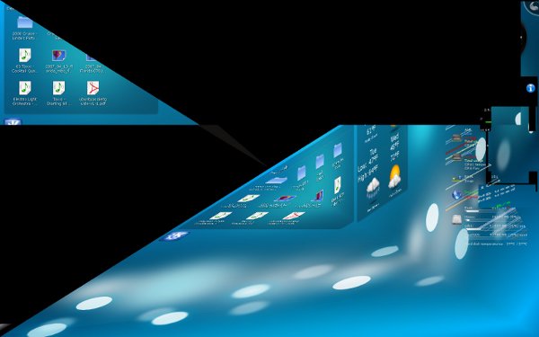

        Sorry for resurrecting a month + old thread but I'm trying to track down a similar issue, except with Nvidia. I haven't done much research yet, this was the first post I came across in the 9.04 forum when searching for kwin, but your description rings true for me with an Nvidia graphics card and the Kubuntu provided proprietary Nvidia driver. I frequently get 'broken mirror' type artifacts on the screen and the only way to clear is to either reload the KWin window manager or log out/in and/or restart Xserver.
        I've actually been doing this for months, and it's not just 9.04, I recall this happening to various degrees in older versions of Kubuntu (I've had the same hardware for 2.5 years now and have always run the latest Kubuntu). So this alone sort of tells me it's the graphics driver.
        I'm running a GeForce 7600 GS graphics card and the 180.44 Nvidia driver version. Any info. or suggestions greatly appreciated!

            Thanks for the tip. I tried a search using my graphics card (GeForce 7600) and saw the three pages of posts you're talking about. Unfortunately, many of them are older and/or not relevant to my problem. I looked over in the ubuntu forums a bit too and there's a ton of posts there about nvidia driver related issues.
            Just for grins, I tried the 96.43.10 driver overnight and woke up to a black screen in the morning (only alt-ctrl-backspace could bring it back to life). So I'm back to 180.44 for now. Got the 'broken glass' affect just a few minutes ago which was fixed by reloading kwin.
            I'm tempted to try the latest 18X drivers release which is 185.18.14 according to this link:
            http://www.nvnews.net/vbulletin/showthread.php?t=122606
            but for now, I'd rather just go with the proprietary driver that Kubuntu provides (leaving the system as 'stock' as possible).
            I've attached a screen shot that I captured when it was flaking out.
            Thanks.

                Thanks for the reply. How about the attached screen shot? That's what I woke up to this morning. Was using compiz instead of kwin, reloaded window manager which fixed but later, had to restart Xorg as it went really funky (broken glass effect as I call it). Tried to get another screen shot but couldn't.
                So yeah, I'm a bit frustrated but perhaps it's getting better? I'm still using the Nvidia proprietary drivers but using Kubuntu's hardware driver manager to install. But maybe we're talking about the same thing (you called them 'Kubuntu free drivers')?
                Anyway, I guess we just continue to wait and hope each iteration gets better. I'm running 9.04 and have been since a week or so before it's debut.
