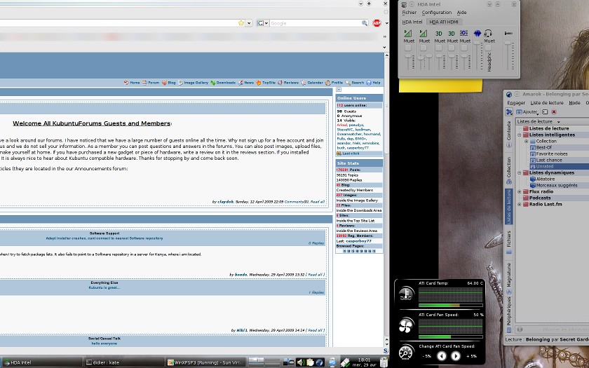

                      Edit: it's happening again right now. Here is a capture of what I see on both screens. I haven't opened any new application and I have had no problem for hours before now.

                        Well, the problem persists. I deactivated all desktop effects, I uninstalled hardware driver to replace it with the one from the ati website... I reseted xorg.conf then tried to reconfigure with aticonfig but no improvement. The bug keeps happening after a period of inactivity. Since I already deactivated the screensaver, I also unchecked PowerDevil options in advanced settings.
