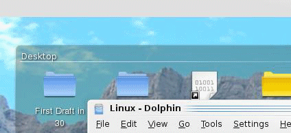

    The setting used to be under Desktop - System Settings, Behavior, General, Menu Bar at Top of Screen. Now all I see is a gray bar across the top of the screen, which inconveniently hides the title bar of newly opened windows. This only appears in one user account; the others, which never had it turned on, are fine.

    Here's what the menu bar looks like (it's the gray band stretching across the top of the screenshot).
      Re: Kubuntu 8.10 - Can't turn off old Current application's menu bar (Mac-OS Style)
      I can duplicate a similar bar in KDE4 by adding a panel to the top. Unfortunately your picture does not show the right corner, where I have a "cashew"
      I can remove this bar by right clicking on it and choosing "Remove this panel"
      Is this the same as your problem

        arochester - no, it's not the same (I tried that also). There's a cashew up there, but it doesn't affect the menu bar. I heard off-line from another forum member that he too experienced this problem, and confirmed it was there in the previous version of Kubuntu. The only fix was a clean install. Arrggghhh...
        As luck (or more accurately, lack thereof) would have it, I ended up doing a complete reinstall. I tried whacking .kde, but that didn't help. I also tried removing kwinrc and plasmarc, also no luck. Then I took a power hit along with a power outage, and even though I have a battery backup with a heavy-duty surge protector, I somehow lost the ability to log in. Triple witching hour, a day after the fullest moon of 2008 :-0.
