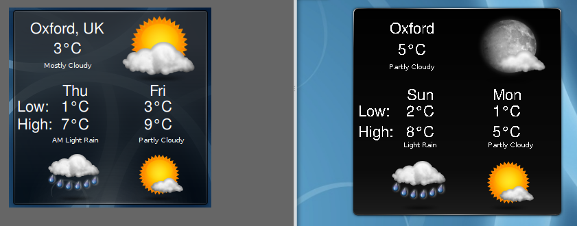

    I'm having an issue with the fonts of a plasmoid I recently installed from kde-look:
    http://www.kde-look.org/content/show...?content=92149
    I don't think it's the plasmoids problem however. I was running the basic weather one that comes with KDE 4.1 for awhile and that one had the same ugly jagged fonts.
    The attached screenshot shows the difference between the the screenshot at the kde-look web page above (probably the author's screenshot?) which is on the left and mine on the right.
    I think it's a system setting somewhere but I can't seem to find it. Any suggestions would be greatly appreciated!
    Thanks!

        Thanks for the tips thus far! I have tried rescaling and it just makes them smaller or larger and still ugly. Tried changing the plasma theme but the fonts remain ugly (background changes and it gets a frame, etc. But same ugly fonts).
        I've also tried messing with font anti-aliasing. Mine was set to 'Disabled' and I tried both System Settings as well as Enabled but neither has any affect. Same ugly fonts!
        I'm stumped! Any other ideas

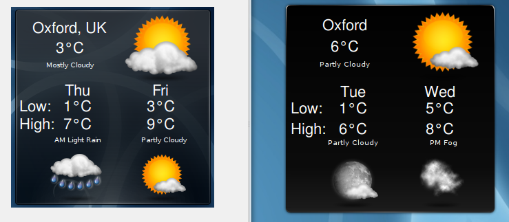

                By golly I found the solution!!! I guess I didn't play with anti-aliasing enough. Fonts are now silky smooth (see attached). What I did was enable anti-aliasing and under the 'configure' button, I checked the box for 'Use sub-pixel rendering' (RGB) and Hinting Style Medium. I have the 'Exclude Range' button unchecked.
                That seemed to solve my ugly plasmoid font problem! Haven't had a chance to see how that affects the rest of the apps and system-wide fonts but perhaps I'll just live with it or tweak a bit more as needed to get everything the way I like.
