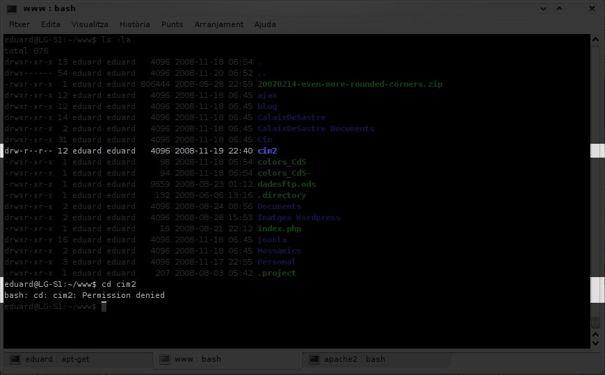

    Some days ago, I had have a problem with my session. Finally, I had to remove my user, and create a new one.
    Now, I have a problem. So Apache don't give permission to view any of my sites, I've made a test: I chmod'ed one web directory to 644. Theorically, I have permissions R and W. But if I try a "cd", it returns a "Permission denied"
    I've attached a image where it can be seen...

    Check all your other entries for directories - they are all executable.
    Do chmod +x and you should be able to cd into it.

        Thanks!!
          Re: I'm not the owner of my owned files
          Thanks for the answer!
          But the solution was than easy as apointed toad: chmod +x.
          I can't acces any web on my pc because apache throw me a fordibben 403, and I think that the problem was the same with this directory, and it was more easy
