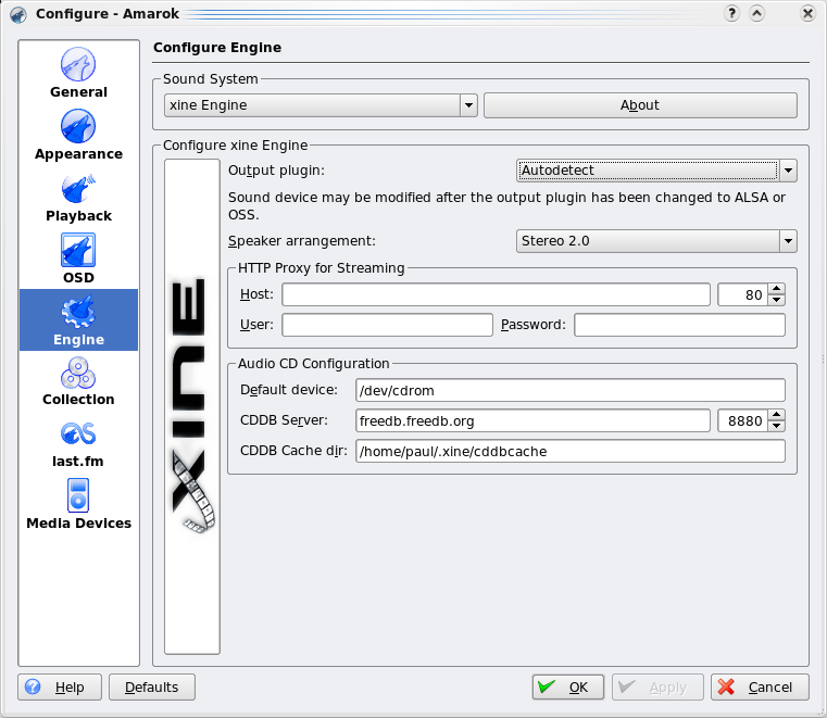

            Check the Engine settings. This is what my settings are:

              my own is identical except the "speaker arrangement" pulldown menu is not selectable. Also I am sure this did not happen ever before but when I opened amarok this error meggage popped up:
              "xine was unable to initialize any audio drivers."
              I expect that explains why I am having a problem, let me know if I'm wrong.
