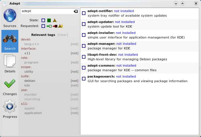

    Update and upgrading adept:
    adept-batch will be removed
    adept-common will be removed
    adept-installer will be removed
    adept-manager will be removed
    adept-notifier will be removed
    adept-updater will be removed
    adept (version 2.1.3ubuntu26) will be upgraded to version 3.0~alpha6+ubuntu1
    libept0 (version 0.5.17ubuntu3) will be upgraded to version 0.5.24+ubuntu1
    apt-xapian-index (version 0.14) will be installed
    python-debian (version 0.1.10) will be installed
    python-xapian (version 1.0.5-1) will be installed

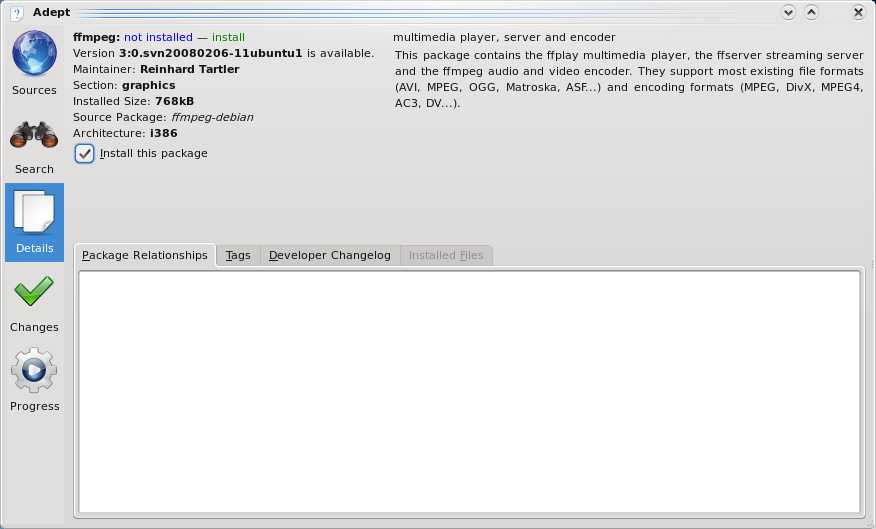

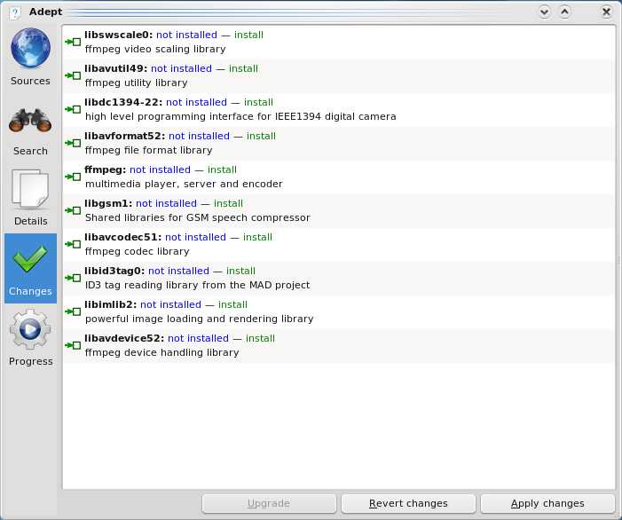

    Installing (ffmpeg)

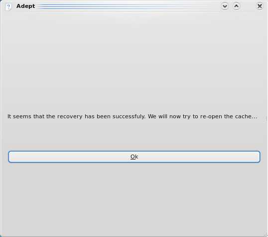

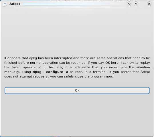

      In the case of CRASH
      Before you edit, BACKUP !
      Why there are dead links ?
      2. Thread: Lost Information

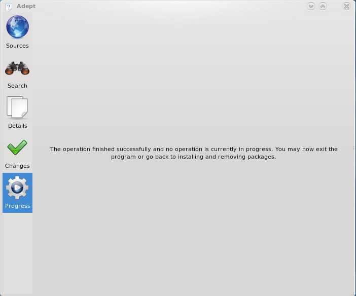

        Adept 3 Alpha 6 is still alpha but it is a good start

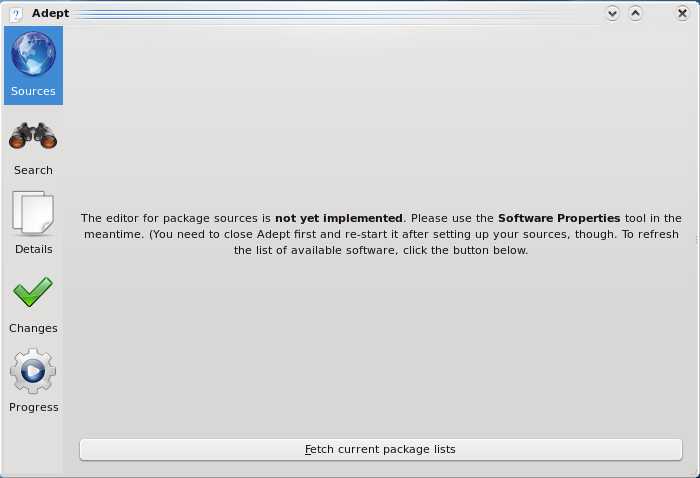

                    It doesn't start from the systray (notifyer) of kmenu you have to do kdesudo apept but looks clean and works well for installing. Sources are missing and I wonder how it will handle large updates /grades.
