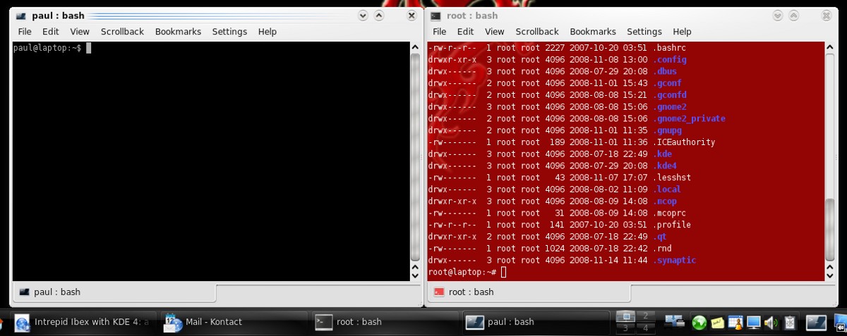

                    Hear is what I put in one of those pipes:
                    Right-click K Menu, select Menu Editor
                    Open the System Submenu
                    Click New Item
                    General
                    Description: Root Terminal
                    Command: konsole
                    Advanced
                    Run as a different user (check this)
                    Username: root
                    I changed the icon to a red console (I copied the existing icon to a new name and used Gimp to change the color)
                    As to the color of the root console in the picture:
                    Start Root Terminal
                    Settings > Manage Profiles > New Profile...
                    Profile name: Root Shell
                    Appearance > New...
                    Click on Background then click the color bar to open the color editor. I chose HTML: #FF0000
                    Set Background transparency: to 10%
                    8)

                          Originally posted by Snowhog
                          User console and Root console sessions (from the K Menu).
                          Wow! My attempt to do that brought out two more interface irritations:
                          1. How to view the attached jpeg? (I'm using Firefox.) I can't just view it directly; I have to save it to the desktop. then scroll through the desktop icons to find it, then open it, and finally delete it so it doesn't clutter up the desktop.
