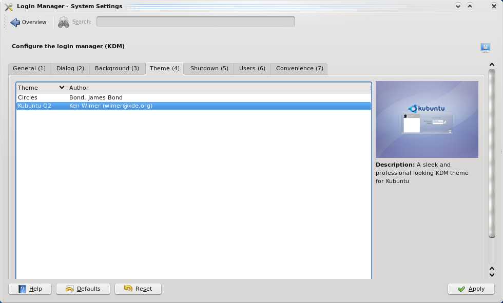

            KDM themes
            > Topic: Installed custom KDM Themes not being listed
            Differences:
            KDE3.5
            Themes are: /usr/share/apps/kdm/themes.
            KdmGreeterTheme.desktop should start with the [GdmGreeterTheme].
            KDE4
            Themes are /usr/share/kde4/apps/kdm/themes/.
            KdmGreeterTheme.desktop should start with the [KdmGreeterTheme].
            Enabling Kubuntu kdm theme
            Kubuntu kdm theme is in the /usr/share/apps/kdm/themes.
            Symlinking:
            sudo ln -s /usr/share/apps/kdm/themes/* /usr/share/kde4/apps/kdm/themes/
            Check:
            ls -l /usr/share/kde4/apps/kdm/themes
            lrwxrwxrwx 1 root root 34 2008-07-01 17:31 kubuntu -> /usr/share/apps/kdm/themes/kubuntu
            lrwxrwxrwx 1 root root 46 2008-07-01 17:31 kubuntu-no-userlist -> /usr/share/apps/kdm/themes/kubuntu-no-userlist
            Changing g to k
            kdesudo kwrite /usr/share/kde4/apps/kdm/themes/kubuntu/GdmGreeterTheme.desktop
            [GdmGreeterTheme] -> [KdmGreeterTheme]
            and saving GdmGreeterTheme.desktop as KdmGreeterTheme.desktop
            Alt + F2 : kdesudo systemsettings
            System Settings > Advanced > Login Manager > General-tab: Use themed greeter > Theme-tab >
