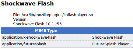

        Open an empty tab in Firefox and enter aboutlugins into the location bar. That should list all your active plugins and the directory they are loaded from. For example, here is what my about:config shows for Flash 10 (see attached image #1):

            First off, thanks Ole Juul for your invitation to post this issue.
            Geez, I had no idea this would be such a big deal. Update:
            Reviewed this thread and took the tip to update Firefox from version 2 to 3.6.6 (btw, through Ubuntuzilla). Doing that and not downloading any plugins, that allowed this "problem" site to play:
            http://bp.concerts.com/gom/kwellsreliefwells062710.htm
            Then, for good measure I installed from the .deb file and without problem Flash:
            Shockwave Flash
            File: libflashplayer.so
            Version:
            Shockwave Flash 10.1 r53
              Shockwave Flash
              Version:
              You didn't say where that output came from, but I assume you have the latest Flash 10 player now. Is that correct?
