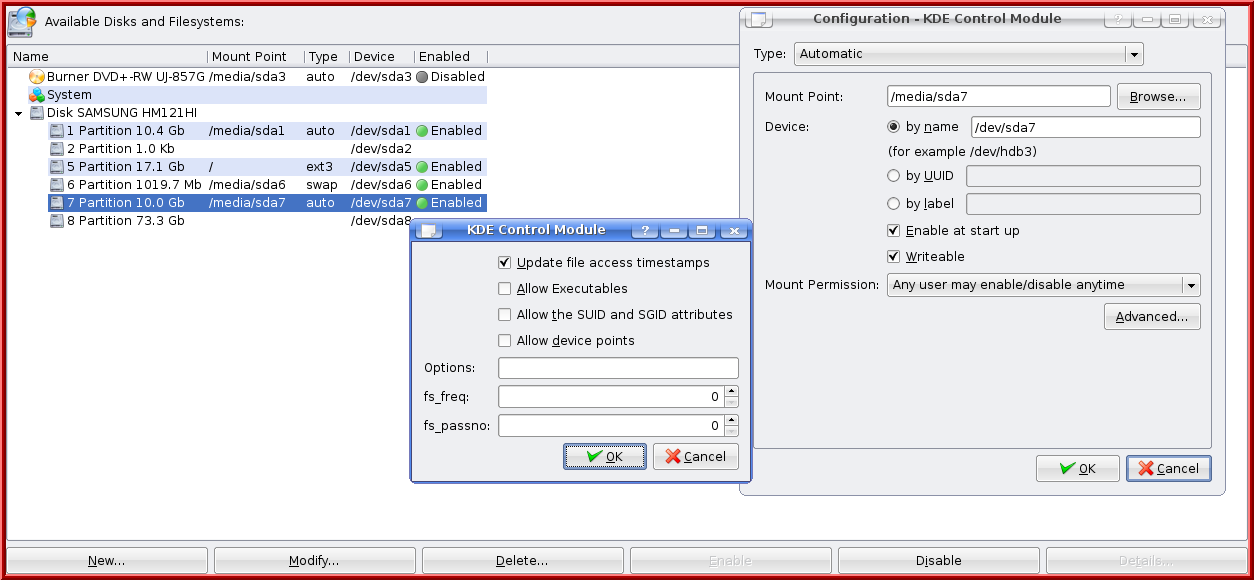

        You don't have to do this for removable devices only for harddrive partitions. Please have a look at the attachment. Maybe there is something wrong? Note: my sda8 is a Truecrypt partition (encrypted) and therefore not automatically mounted.

          I've set the right options in Systems->Settings->Advanced->Drive managment.
