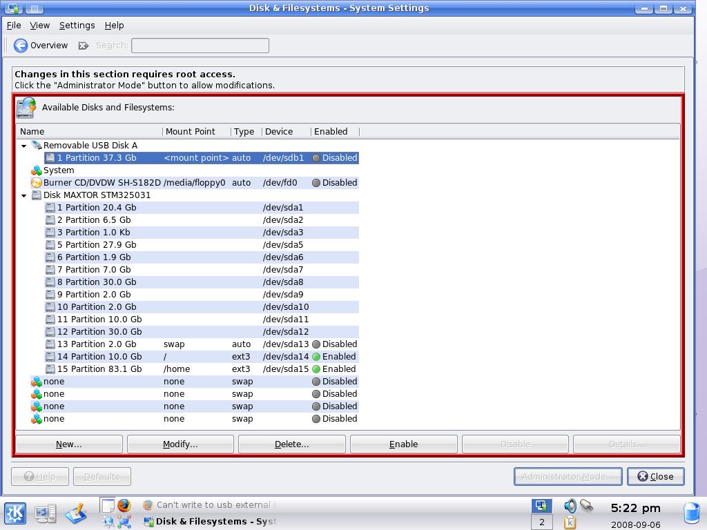

            With it running and connected, you might take a look at the settings for it in KMenu>System Settings>Advanced>Disks & Filesystems. Some folks have had luck adjusting permissions and ownership of USB devices there.

              With it running I took a picture of disks and filesystems and attached it. I noticed that neither the /dev/sdb1 or /dev/sda13 are enabled.
              I have looked around but am unsure of what to edit and how to go about it.
              Is the swap partition supposed to be mounted at boot?
