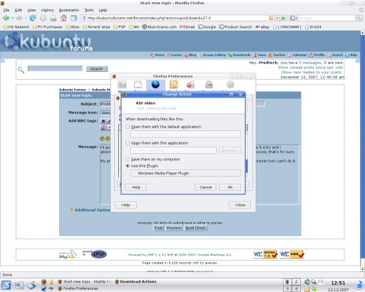

    My problem lies with firefox. I want to be able to stream WMV's from websites in my browser but i can't do it. I have attached a snapshot of my browser file type page for firefox, and as you can see i don't have a choice on the actual plugin i can use inside the browser itself. I do have mplayer and the mozilla plugin for mplayer installed along with VLC, Kmplayer, and Kaffeine although i think Kaffeine was installed by default with the OS

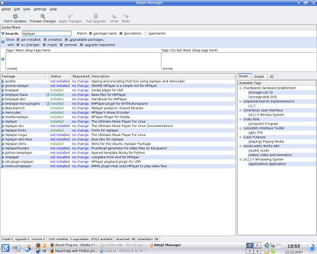

          What about mplayer itself. Does Adept Manager show that it is installed?
            Re: Need help with Firefox please

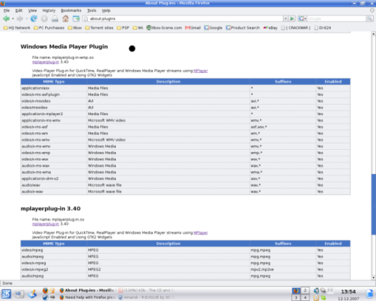

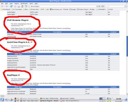

            Yes it is, it's listed for almost all of my plugins for some reason. I mean WMP, quicktime, DivX, and Realplayer all seem to be using mplayer. I attached a pic of the screen.
            *Yes Mplayer itself is installed, and it's listed in adept manager

              In the aboutlugins section of ForeFox you have in the above screen shot, just after RealPlayer, you should have an entry reading as "Windows Media Player Plugin". Does that show up? If not, go to kmenu --> System --> Adept Manager. Run that and in the search bar, type mplayer. What is listed there.
                Yeah i have Windows Media Player listed after Realplayer and in adept manager i have mplayer and the firefox plugin both installed.

                    OK. I re-examined your first screen shot. Tiny . Anyway, it actually appears to be trying to Download that to play locally or something instead of embedded in the web page. The second option stated use this application. Try typing mplayer there and see if it will at least open it up and play. I can't say for sure why it is downloading instead of embedded. Maybe that is the way that website is designed. Don't know, but instead of telling it to use a particular plugin, tell it to use this application and specify mplayer.
                      Ok, i have no idea what's going on now. First off, i checked for W32 codecs and yeah i have them. I decided to uninstall VLC and specified the second option on the file type handling screen to mplayer manually, which wasn't too difficult, and i got it to actually try to open up the files in the browser, or at least a popup browser windows which is the way it's supposed to be, but now all it does is try to log onto the stream and stops before it plays the video. Even when i try to play it manually it just refuses, and stops every time.
