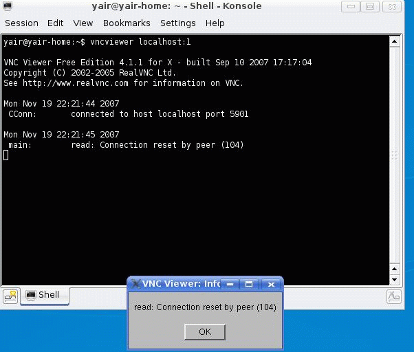

    The strange situation now is:
    - I can still connect from the XP using the same password I created for the X11vnc. I have no idea how it works.
    - I cannot connect locally using: vncviewer localhost:1.
    The attached fig shows what happens when I try.
    How to I resolve it?
    Thanks,
    Yair

    Well, I forgot to turn off Krfb. Now it's off so I actually cannot connect from the XP. So I'm still with the main problem shown in the fig above.
    Following some advice I I've tried to manually issue the following command to see if Xvnc can start:
    sudo Xvnc :2 -query localhost -geometry 1280x1024 -depth 16 -once -fp /usr/share/X11/fonts/misc -DisconnectClients=0 -NeverShared passwordFile=/root/.vncpasswd
    I got the following:
    Xvnc Free Edition 4.1.1
    Copyright (C) 2002-2005 RealVNC Ltd.
    See http://www.realvnc.com for information on VNC.
    Underlying X server release 70000000, The X.Org Foundation
    Tue Nov 20 18:22:38 2007
    vncext: VNC extension running!
    vncext: Listening for VNC connections on port 5902
    vncext: created VNC server for screen 0
    Could not init font path element /usr/share/X11/fonts/misc, removing from list!
    Fatal server error:
    could not open default font 'fixed'
    Any help?
    Thanks.
